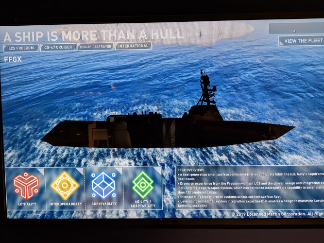

Did Lockheed Martin ever release what their final proposal for FFGX looked like before they withdrew from the competition? All I remember was this untextured render from a trade show.
