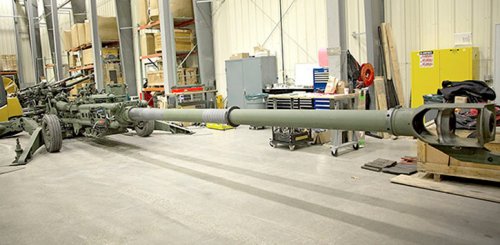

I think it's the other way around. The initial application for ERCA was for Paladin; the new initiative is seeing if they can adapt the same tube to the M777 instead.

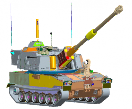

M109A7 is interesting. It has kind of sneaked by under the radar, but it seems to be basically a new SP howitzer based on Bradley running gear that has some parts in common with the old M109. Compared to the A6 Paladin, the A7 has an entirely new hull, a new suspension (with fewer road wheels even), a new engine (again from Bradley), new electric turret drives, an electric loading system with a semi-auto rammer, etc.
https://www.ausa.org/publications/armymagazine/archive/2014/Documents/07July14/SoldierArmed_July2014.pdf
About the only things in common with the A6 seem to be the turret shell and the actual gun tube. And it ERCA works out, that may go away as well. See slide 10 here:
http://www.dtic.mil/ndia/2014munitions/Pelino.pdf
