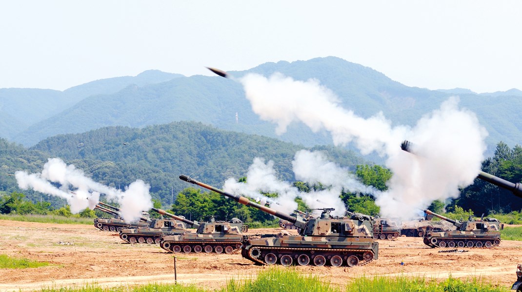

The K9 nicknamed Thunder is a 155mm 52 caliber self-propelled howitzer fully designed and developed in South Korea by the company Hanwha Techwin, formerly known as Samsung Techwin. The first contract for the K9 artillery system was awarded to Samsung Aerospace Industries on 22 December 1998. The first howitzer was rolled out on 17 December 1999 and was fielded to the Republic of Korea Marine Corps in Yeonpyeongdo.
The K9 is based on a tracked chassis armored vehicle with a turret mounted at the rear of the hull. It has a crew of five including a driver seated at the front left side of the hull and four in the turret consisting of commander, gunner, assistant gunner, and ammunition loader.
The hull and the turret of the K9 are of all-welded steel armor construction providing protection against firing of small arms 14.5 mm armor-piercing rounds, explosion pressure and fragments of 155 mm HE (High Explosive) rounds and anti-personnel mines all around. The vehicle is motorized with an MTU MT 881 Ka-500 8-cylinder water-cooled diesel engine developing 1,000 hp. coupled to the Allison ATDX1100-5A3 transmission. It can run at a maximum road speed of 67 km/h with a maximum cruising range of 360 km.
The main armament of the K9 consists of one CN98 155 mm 52 caliber artillery gun manufactured by Kia Heavy Industry and has a maximum firing range of 40 km using K307 base bleed ammunition.
