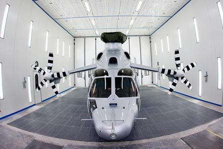

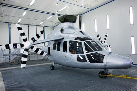

Now the five remaining...
Here is the video: http://www.youtube.com/watch?v=LxhogYKwV7Y&feature=player_embedded

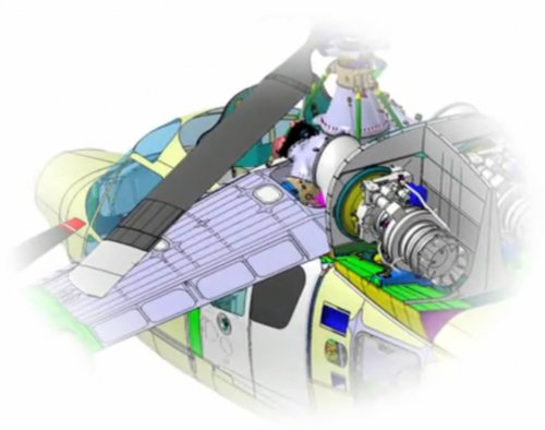

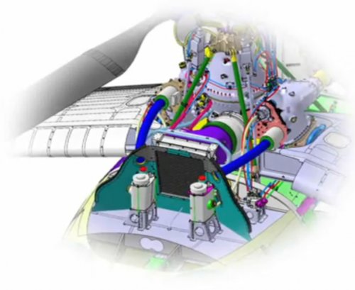

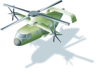

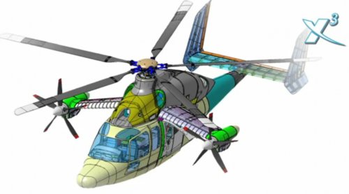

The press releases have been rather coy about how the engines and propellers/rotors are actually linked up. I see Eurocopter touting this as a less complex alternative to Sikorsky's X2, and I'm wondering if they simplified by using one engine for the rotor and a separate one for the props. Given that the engines used in the X3 demonstrator (RTM 322) are at least twice as powerful as those in the original EC155 airframe (Arial 2C2), I think it's quite possible that they separated the two drivetrains entirely. Simpler, certainly, but much less efficient from a weight perspective.
Nice, simple and clever design. Marketing of the new vehicle is horrible (as always in the Europe). Here are some stills from the video. BTW, noteworthy is the wing oscillation during the flight.

Thanks; I can't get the video to work right now, so the stills are very helpful. So it is a single transmission with both engines driving all the propulsors.

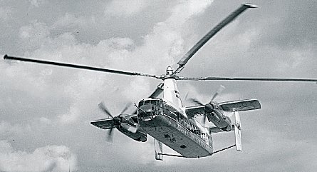

The Fairey Rotodyne (more or less) flies again!

Demon Lord Razgriz said:
Comparing it to the X2 designs, this X3 seems to be forgetting a key detail in the X2 design. X2 has a coaxial tandem rotor, which negates the primary problem with single rotors at high speed losing lift on one side.
Which is why they are slowing it down. Watch the video.

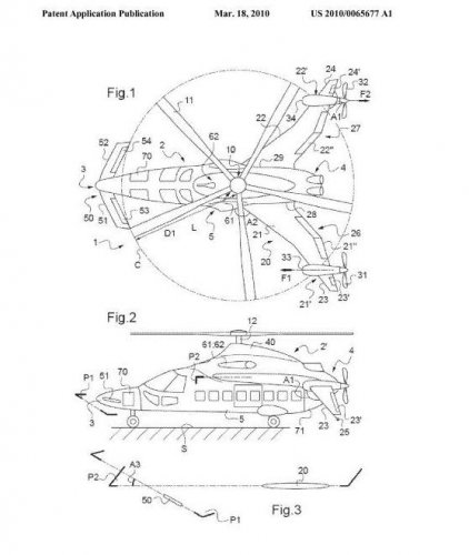

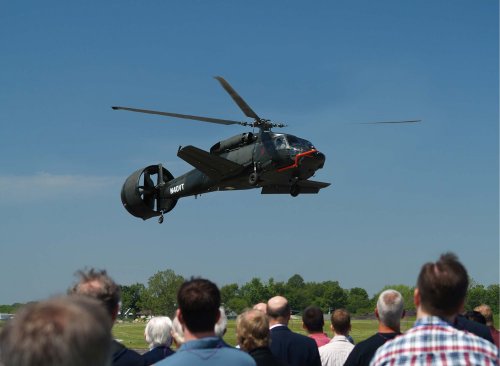

BTW, don't forget that this is only the first first flight this year from the two announced. If the second "first flight" happens, than it will leave us four remaining...
If i understand the concept correctly it is more like the Lockheed AH-56 or the Sikorsky S-66 concept
http://www.secretprojects.co.uk/forum/index.php/topic,941.0/highlight,ah-56.html
I would extend comparisons to the even earlier Fairey Gyrodyne (spell check?). This may not fly as fast as a tiltrotor or even the X2, but there is much to commend in experimenting with something that is relatively low-risk and still delivers respectable performance.

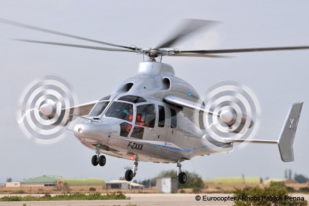

Eurocopter just released a set of high-res photos: http://www.eurocopter.com/site/en/ref/Photos_1100.html#/content/RUB_1100/ Now I am much satisfied.

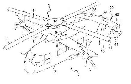

what's the identity of the design you posted under the filename X4.jpg?
Its the Eurocopter patent, filled in the US at the beginning of 2010. That are the facts. Now the speculation is, what it represents - it is believed, that it represents the X4 shape. Wait until the end of the year. Originally, both X3 and X4 demonstrators were announced for the third quarter of the 2010, but the X4 suffered some delays because of the funding from the French government. However Eurocopter wants to present both demonstrators on the next Heliexpo.
