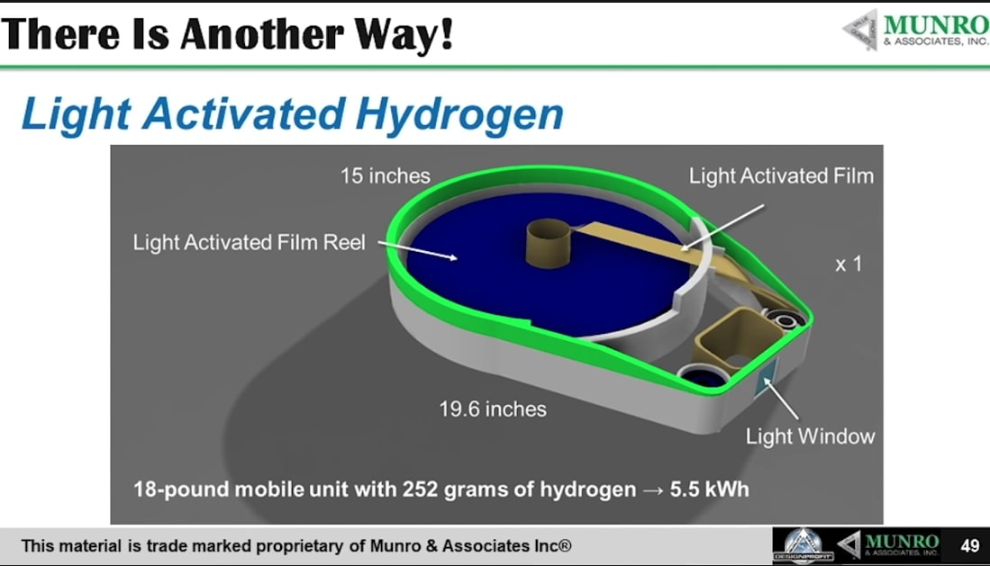

Here comes a new challenger~~
So how does this tech look? I'm looking at 8.1 kg unit storing 0.252 kg of H2 from one of the slides, but no pressurization, maintaining low/high temperatures and all that.

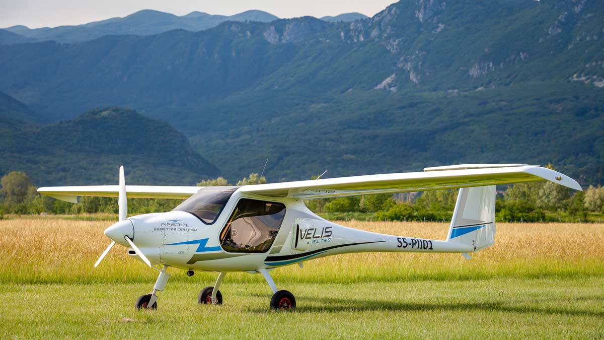

The Danish defense ministry said Thursday that it will lease two electric trainer airplanes as a test, adding that it is the first country in the world to do so.
The single-engine, two-seater Pipistrel Velis Electro is an electric-powered Slovenian light aircraft intended primarily for training use. It will complement the Danish air force’s current training aircraft, the Saab T-17 Supporter, which is used for school flights and maintenance training flights.

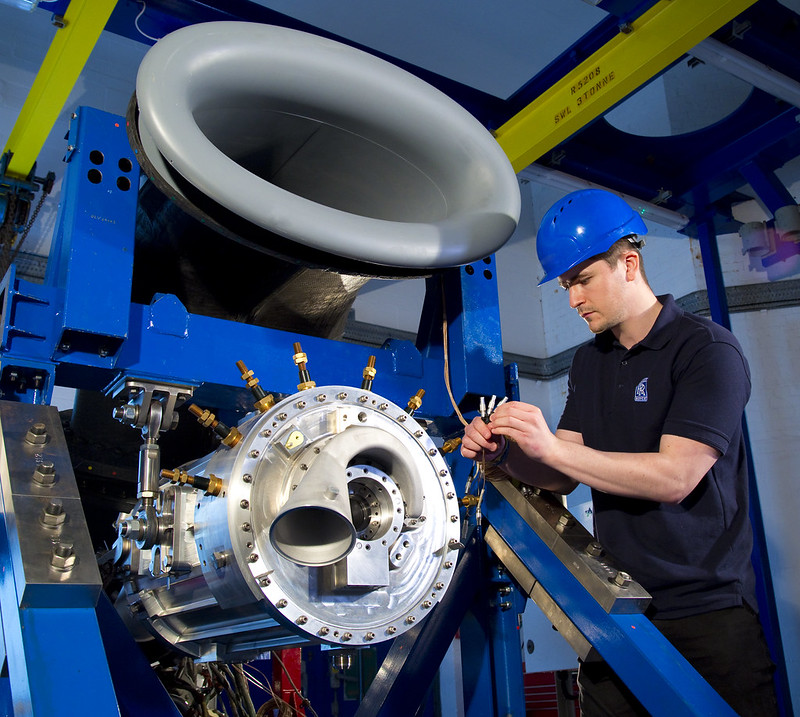

Rolls-Royce has started testing the first elements of the most powerful hybrid-electric aero power and propulsion system in aerospace at a newly-renovated testbed.
The tests are part of the 2.5 megawatt (MW) Power Generation System 1 (PGS1) demonstrator programme, for future regional aircraft.
Rolls-Royce has begun testing the AE2100 engine element and specialist controls and thermal management system, supported by a system integration generator, at our Testbed 108 in Bristol, UK.
