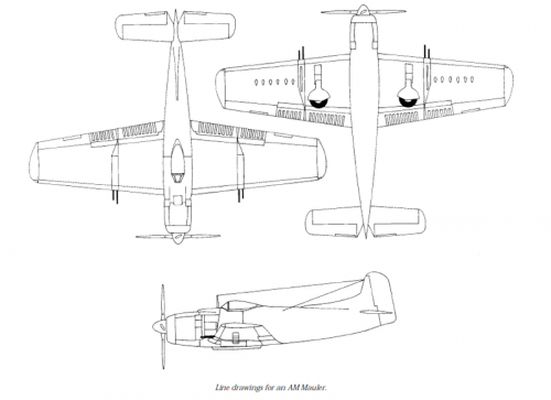

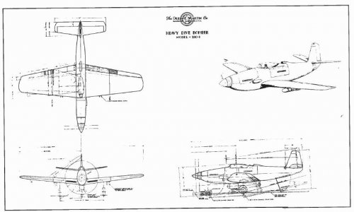

Hi all,
found this early drawing (Model 210-1) of the Martin "Mauler". (Source: L+K)

That twin engined early design is very interesting, is there any additional data in the source? Are those Allison V-1710 engines? Any date?
