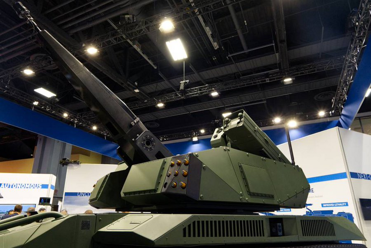

I don't want to go too off topic but it's interesting to me that revolver cannons are the weapon of choice for these new systems like Skyranger. Compared to rotary Gatling-type autocannons they must be much more adaptable to using smart airburst ammunition like AHEAD but I'm wondering why in the past they've never really been used in land-based air defense systems either in self-propelled or towed form?
I'm not really sure revolver cannons are more adaptable to airbursting rounds, it's just that such rounds have generally favoured a higher calibre and there aren't many 35-40mm gatling guns.
1) revolver cannons spin up faster, so the first half-second of burst fired is at closer to 80% of nominal cyclic rate instead of the ~60% of a gatling.
2) the smart airburst ammo needs to be bigger diameter, and there are very few large bore gatling cannons.
