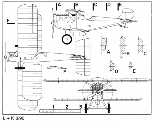

If needed, I can scan the drawing in better quality.
Nice drawing redstar72 ill have bought the booklet about D.1 two weeks ago from the wind sock series very cool booklet I must say!
Here is a better scan of the L+K Dornier D.I drawing.
Also technical data:
Wing span – 7.80 m
Length – 6.37 m
Height – 2.53 m
Wing area – 18.70 m2
Empty weight – 710 kg
Takeoff weight – 890 kg
Maximum speed – 201 km/h
Service ceiling – 8075 m

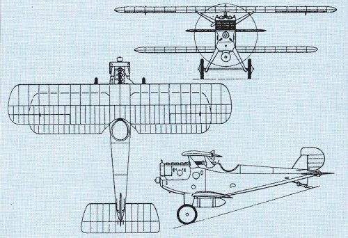

Drawing from "Jagdflugzeuge der Welt".
