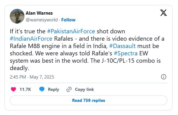

Did the SPECTRA EW suite contribute to the alleged IAF Rafale loss on the 7th May 2025?

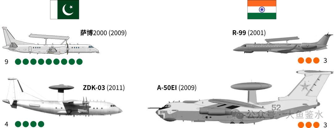

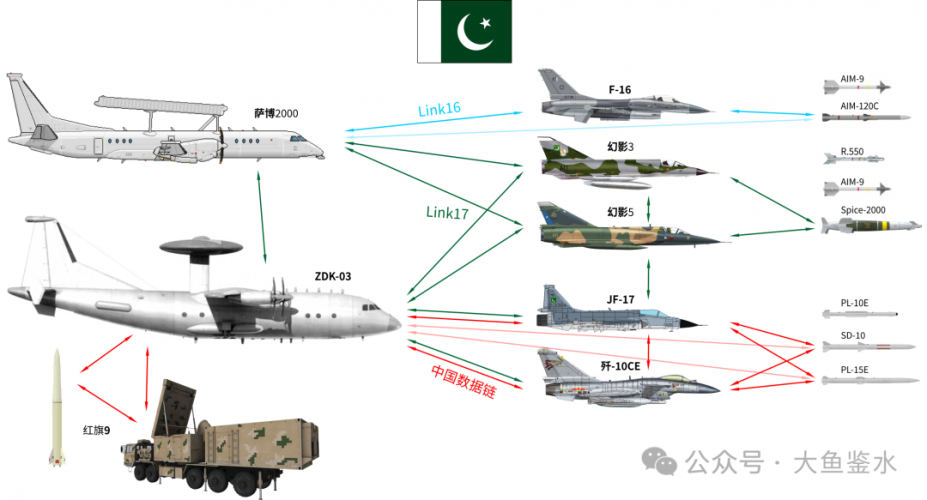

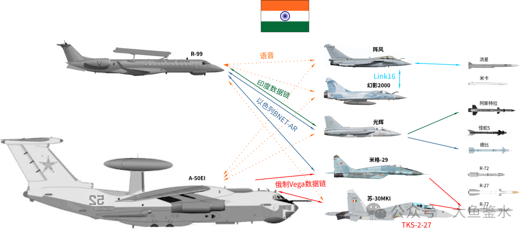

Let's try again to return the thread back on track (derailing in chinese is cheating!). We can have a great 1812 room elsewhere.

I think it was just a well timed interception mission. I’d select several red flights that I had a good sense of when they’d be landing or in the pattern in a low energy, low agility state - like flaps and gear - and time PL-15 salvos to arrive at that moment where surprise and vulnerability are maximized, with data link guidance from a non-shooter until the PL-15s went pitbull.
There are other scenarios that might include exquisite battlefield surveillance & targeting and intense broadband EW jamming from a third party’s unmanned, LO AMTI and jamming UAVs… but let’s not go there.
