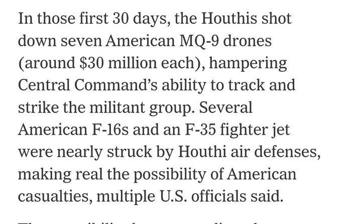

Even now the US coalition is taking relatively high losses in Yemen with dozens of coalition aircraft shot down, and hundreds of vehicles destroyed. Yemen even came close to hitting an F-35 and some naval ships according to the latest reports.
