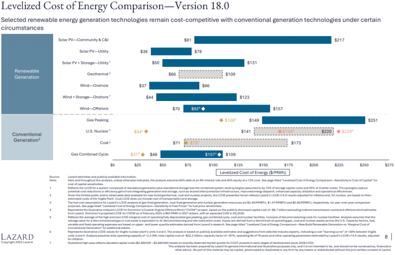

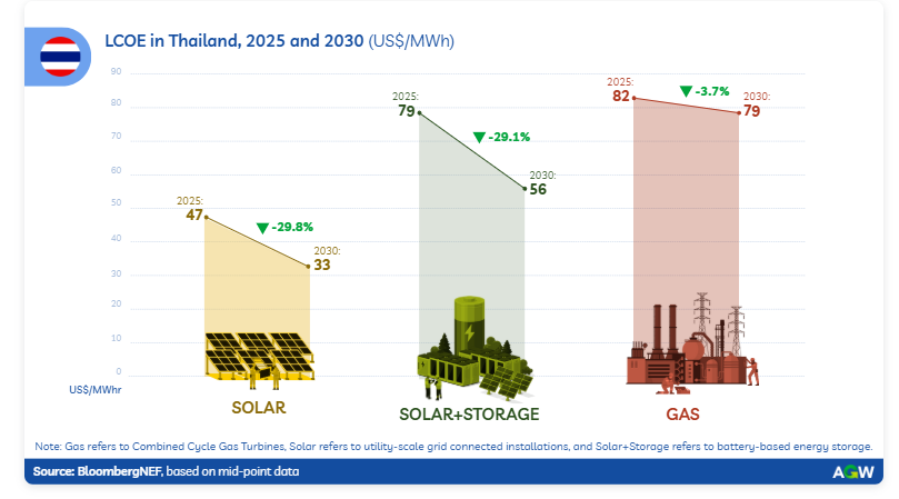

WRT renewable energy costs:
Sources:
https://www.popsci.com/story/environment/cheap-renewable-energy-vs-fossil-fuels/https://www.lazard.com/media/xemfey0k/lazards-lcoeplus-june-2024-_vf.pdf
And as for the cost of solar panels:
https://www.irena.org/Publications/2024/Sep/Renewable-Power-Generation-Costs-in-2023
The bottom line here is that the cost of electricity generated from sources such as solar is getting cheaper and the costs of the things such as solar panels used to generate it are also getting cheaper. One of the other advantages often missed is that things such as this can be incrementally grown unlike traditional fossil fuelled or nuclear solutions.
