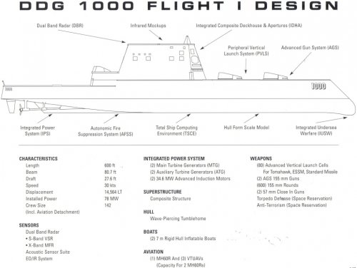

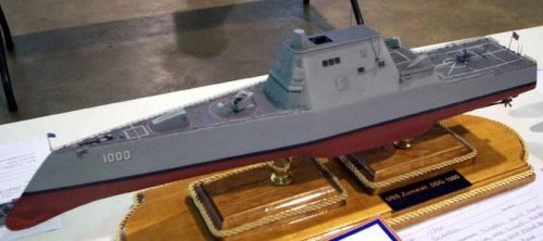

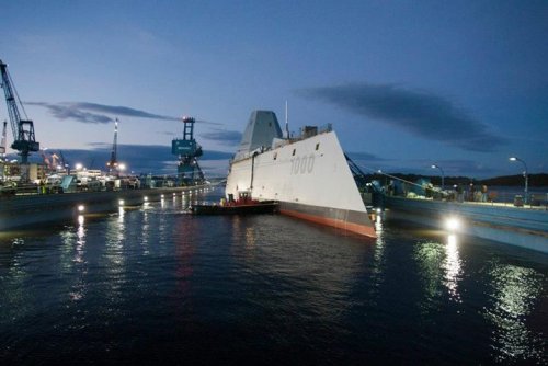

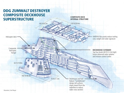

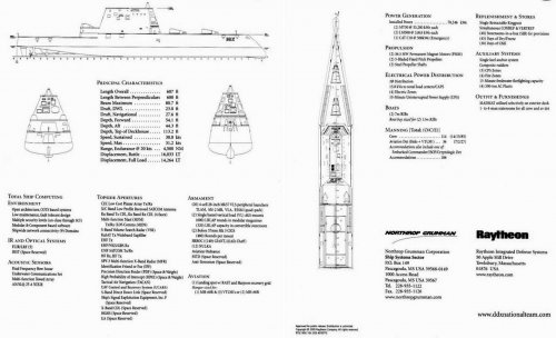

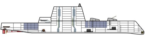

Various pics from my harddisk:
Deckhouse installed. http://www.navyrecognition.com/index.php?option=com_content&task=view&id=797
