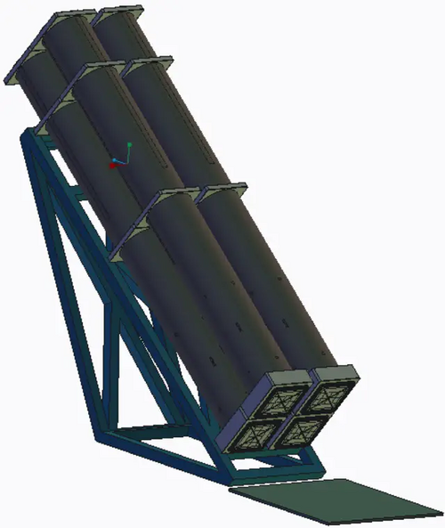

That looks like it could replace the Harpoon canisters...
It was offered at one stage for the OTH missile requirement that NSM is now filling.
"Dimensions and configuration specifics are not publicly releasable at this time, but in general, we are comparable to the Harpoon launcher in space, weight, power
It looks like it uses the Mk-114 launch booster from the RUM-139 VLA.
It does. And LM acknowledges that it's kinda overkill for the purpose, but they make the booster themselves, so they're sticking with it unless someone funds a shorter one. Australia made some noises in that direction, because the VLA booster plus LRASM missile is too long for Tactical Mk 41. But nothing recent, I don't think.
