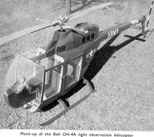

In October 1960, the Army submitted a request for proposals (RFP) for the Light Observation Helicopter (LOH). By January 1961, 12 manufacturers had responded with 19 designs;
1) Boeing/Vertol Model V-13? or V-14? ...(or Boeing Model B-8??)
2) Bell Model D-250---YHO-4 and ...
3) Cessna Model CH-4
4) Gyrodyne Model ? ...
5) Hiller Model H-1100---YHO-5 and ...
6) Hughes Model H-369---YHO-6 and ...

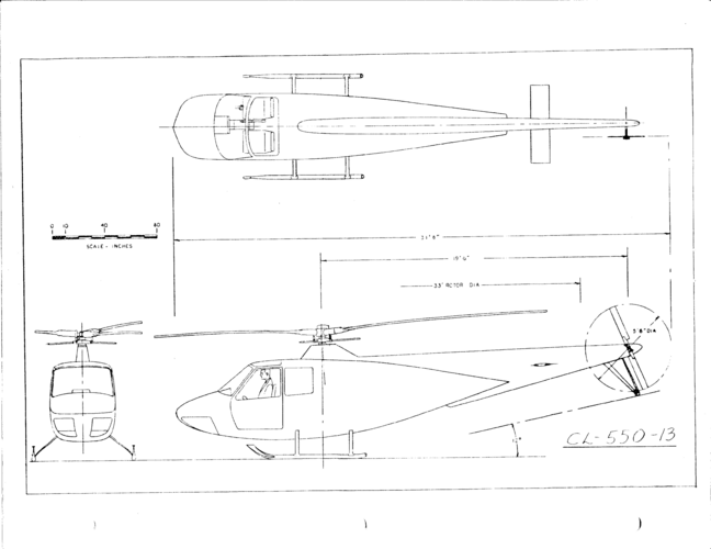

Hi Skybolt!
What are the projects offered by Lockheed?
If you know if you can please show.

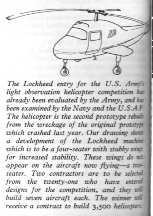

Lockheed Model CL-532---LOH proposal (my opinion)
What can we say about this?
Some source of LOH competition:
AW&ST,1961,V.74, Nunber 22, 29 May, p.27
(my dear Jemiba, you can show PDF(or ?) of this page)

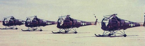

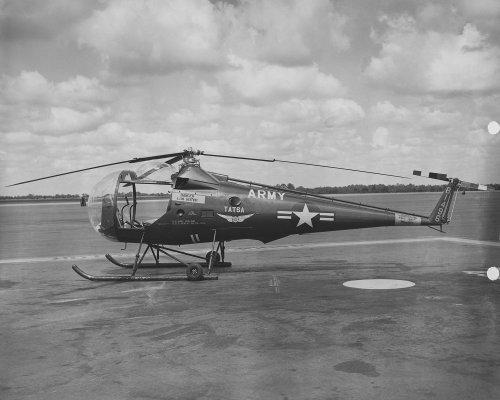

Greetings All -
Brantly offered their design for the competition but in the end, the Army deemed it too small and returned the 5 helicopters to the manufacturer.
Enjoy the Day! Mark

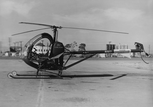

Greetings All -
A little more digging around and it appears that the YOH-3 and the YOH-2 were the initial submittals to replace the OH-13 and OH-23. When the Army deemed them too small and insufficient for the job, the LOH competition was initiated. Here's a photo of the other entry in the initial competition, later to be used as a trainer called the TH-55 Osage.
Enjoy the Day! Mark

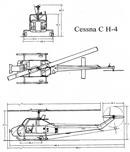

Cessna's LOH contender was the CH-4.
[font=arial, impact,helvetica]The CH-4 LOH proposal was submitted in full to the Army in January, 1961 to kick off the year. An award announcement was expected by May, 1961. Companies submitting proposals were Bell, Hiller, Boeing, Cessna, Gyrodyne, Kaiser, Kaman, McDonnell, Republic, Hughes, Lockheed and Sikorsky; a dozen contenders for two spots. The CH-4 mock-up is pictured below; the turbine engine compartment is located behind the rear seats.[/font]

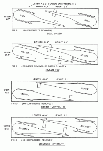

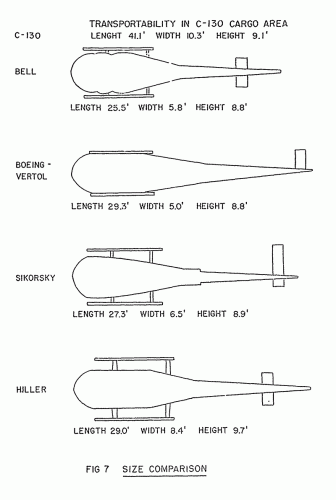

All LOH contenders (20 proposals by 12 companies):
  • Bell D-250
  • Bell D-251 (T-72)
  • Boeing-Vertol 131
  • Cessna CH-4
  • Gyrodyne 66
  • Kaiser KD-161
  • Hiller 1099 (T-72)
  • Hiller 1099 (T-74)
  • Hiller 1100
  • Hiller 1101 (T-72)
  • Hiller 1101 (T-74)
  • Hughes 369
  • Kaman K-130
  • Kaman 130A
  • Lockheed CL-418
  • McDonnell 158A
  • Republic RH-60 (T-72)
  • Republic RH-60 (T-74)
  • Sikorsky (Primary)
  • Sikorsky (Alternate)
NOTE: Bold type indicates the four proposals retained after the first selection.

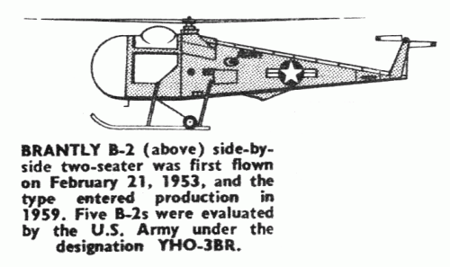

A profile view of the Brantly B-2 as evaluated by the U.S. Army (from RAF Flying Review in 1960):

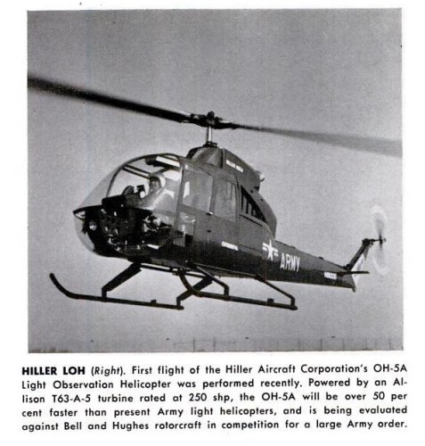

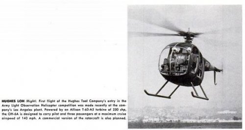

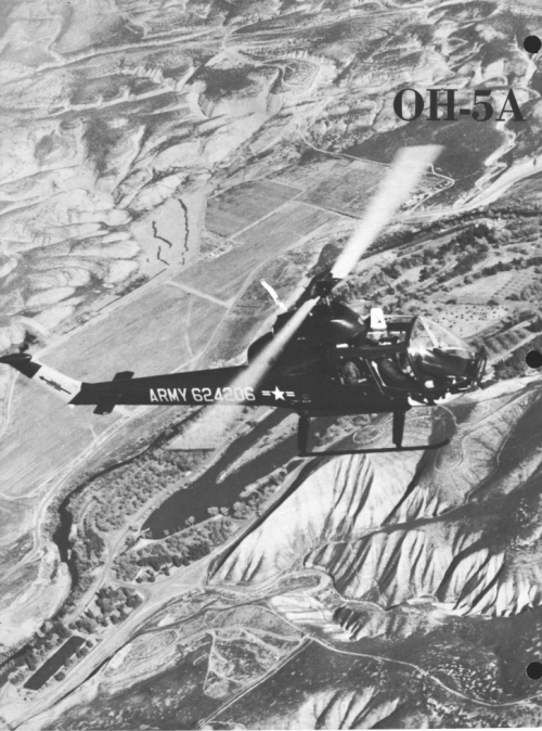

The Fairchild Hiller YOH-5A's and Hughes YOH-6A's first flights from Flying:
