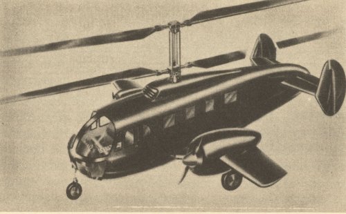

Gyrodyne designed, but not built, a similar looking helicopter. I don't know the designation or the timeframe, but a picture is attached.

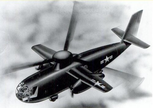

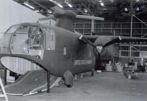

Artist's impression (top) of McDonnell XHRH-1 as it would have appeared in flight.
The full-size mock up (bottom) of the McDonnell XHRH-1 showing the nose loading ramp.
Source: Francillon, René J. McDonnell Douglas Aircraft Since 1920 Naval Institute Press 1990
My be you are right my dear Jos,
that is for Gyrodyne design,and it is called GCA.3,and this helicopter developed in
1951 and called Helidyne,also accommodated 18 seat,and I con give you all of
its data,please see;
http://www.secretprojects.co.uk/forum/index.php/topic,1192.msg104486.html#msg104486
