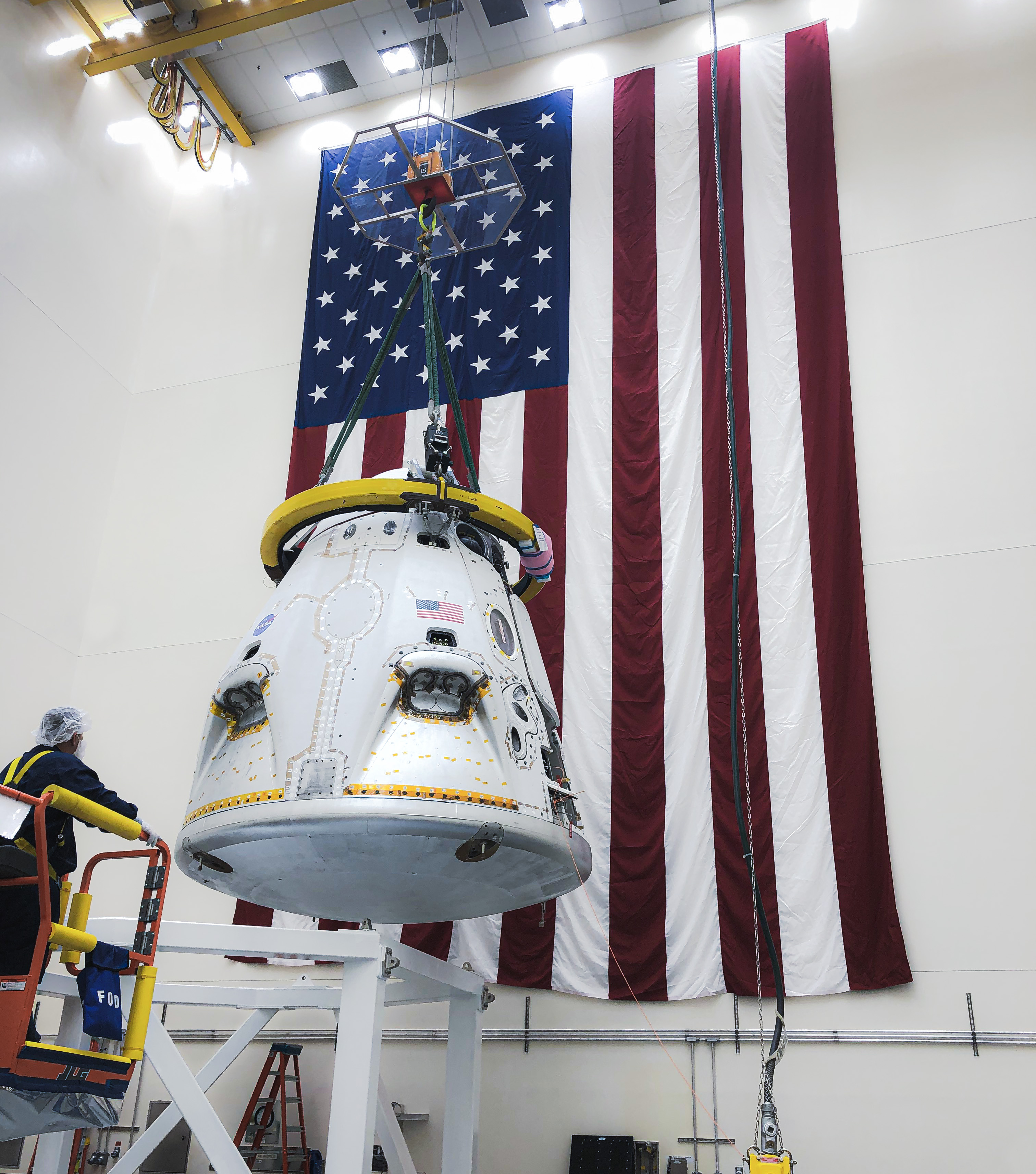

Keep in mind though that the capsules aren't being reused, so how softly they land shouldn't really affect costs (though I can see recovering Dragon from sea more expensive in terms of service equipment than Starliner landing somewhere more convenient on land).
What do you mean not being reused, of course they are. This article talks about how minimal the refurbishment will be before is used again.
Both Starliner and Crew Dragon are being designed for multiple reuse. Did you think they spent a fortune building them just to dispose of them after one use?

My bad, I was thinking of how (for Crew Dragon) they won't be reused for manned flights - ie that they fly a crew up to the ISS and back, but then only ever carry cargo afterwards.
