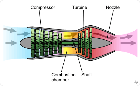

you can see a Rocket engine combustion as constant explosion
turbojet on the other hand is a gasturbin
a lot of Moving parts in combustion chamber
so the only way to use H2O2 /kerosene in Turbojet is as Afterburner in Nozzle
