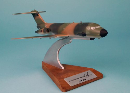

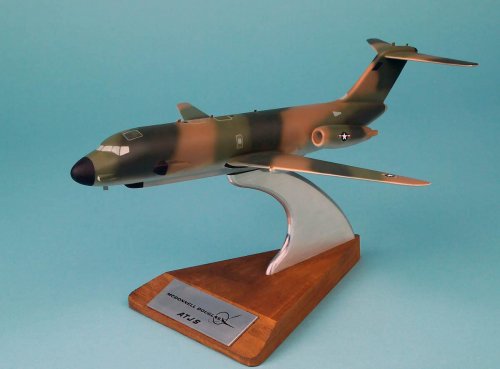

The attached Douglas factory model photos might be the concept you are referring to: Douglas DC-9-10 ATJS (Advanced Tactical Jamming System?). The model features lots of blisters, antennas, roof panels, radomes, heat exchanger intakes and a big canoe fairing on the bottom.
I did not see a reference to the ATJS in Terry Waddington's DC-9 book. If anybody knows anything about ATJS, please do come forward!

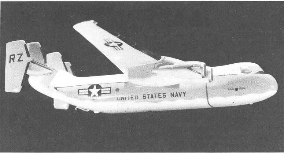

Further to the first post on this subject, I came across the following proposal regarding a pure jet powered variant of the C-2 Greyhound in the May 1972 issue of Air International

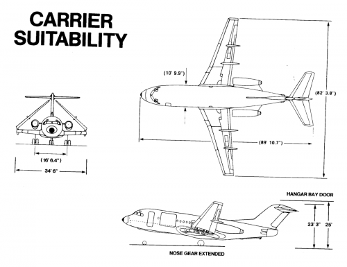

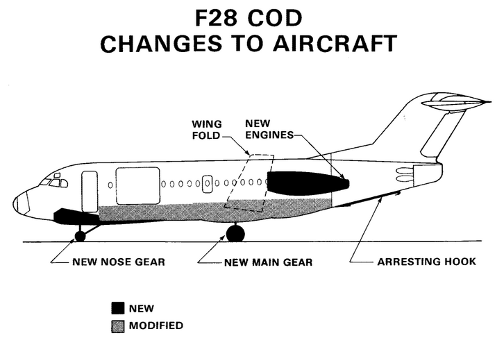

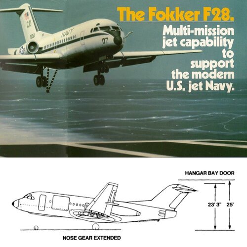

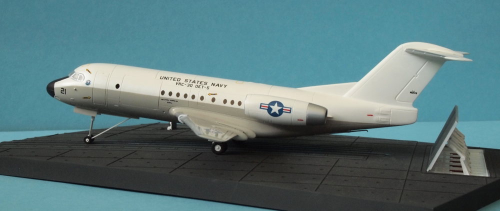

I believe Fokker had also a design for a carrier-based F-28
I'm still disappointed they didn't proceed with any of them. It'd have been so cool to see this in real life:

Here from the early 70's an concept of a Grumman C-2 with four jet engines (TF-3 ?).
The Shadow of the Eagle @clemente3000
The primary source might be a magazine like AW&ST from that time period.

I'd love to see a model or a deck layout, with say 2 x F28 on deck.

the C-2 and E-2 are small enough to be stowed in the hangar. The F-28C was designed to allow this as well: one of the functions of the telescoping nose gear is to make the tail clear the hangar door.
