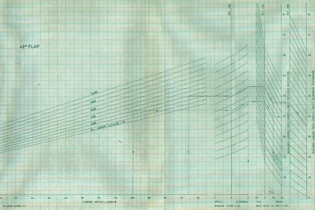

Me neither. What's the ordinary landing distance of a F28 ? Can't see how it could be less than 1000 m, and cutting that to 200 m gets into STOL territory - think YC-14 / YC-15.
Ordinary landing distance is specified at about 1000 m, which should be with a full payload and no wind, at the kind of deceleration airlines are comfortable with. The other end of the spectrum is a 'maximum energy stop', which is only done in emergencies and during the certification process: plane at MTOW, abort the takeoff at V1, brake as hard as possible. - for certification this must be done without a fire breaking out, usually the wheels will get hot enough to trigger the overpressure valve in the tires so you'll end up with a bunch of flat tires.
Found a landing chart:
So at light weight and a 40kt headwind (28kt ship speed plus a moderate 12kt wind) gets you down to 1500ft of 'normal' runway required.
