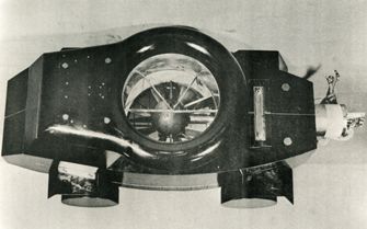

Thanks for the extra pics. I think looking at the Wind Tunnel model that the Shorts vehicle is the one in the Pye Book.
Sticking to the Jumping rather than Flying Jeeps, it is interesting to note that the BAC P35 vehicle was not cancelled until 1967 which suggests that the Army were serious about needing a jeep that could clear the many obstacles to be found on the crowded North German plain ( or perhaps rubber plantations in Malaya or rocky terrain in Aden). The new designed Troop Carrier (FV432) and recce families (CVR(T) Scorpion and co CVR(W) Fox as well as the High Mobility Load Carrier (Stalwart) all had river crossing capabilities. However, by the 70s this was dropped and the Stalwarts rarely used the off road capability (I read somewhere that they had to drive onto rough ground occasionally to stop damage to their systems (sorry I technically dim).
The Helijeep requirement presumably lapses with the arrival of the excellent Scout and Alouette II in Army use.

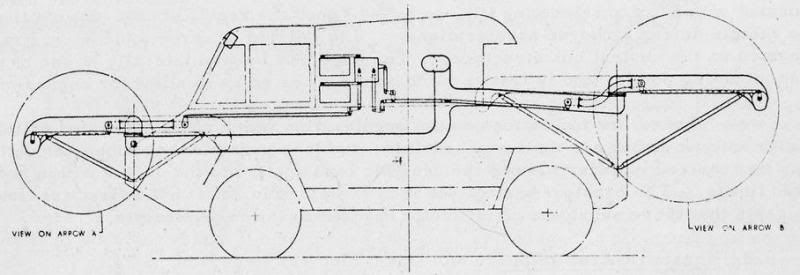

uk 75 said:
Hope this works. I have finally tracked down a copy of the Pye Book of Science
from 1963 and on page facing 106 is the photo of "proposed jumping car: jet lift
army observation vehicle with ability to leap over almost any battle obstacle".
There is no further info in the accompanying article nor is the photo attributed.
I think it is probably a Handley Page design mounted on a Haflinger chassis. I remember
it looking bigger and more like a one ton Land Rover, but now it is here I think it is
a Haflinger.
Looks ready for a spin down the King's Road with Peter Sellers at the wheel!
It was a Shorts PD.46.

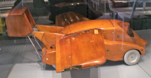

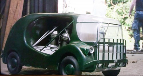

Watching a programme last night on the UK channel Quest called Salvage Hunters and this little number popped up towards the end... apologies for the quality but it was taken on my phone...
Appears to be a Jumping Jeep model by Hawker Sidderley if the HS on the front bumper is anything to go by...
If anyone is wondering it may still be for sale with Drew Pritchard Antiques in North Wales...
http://www.drewpritchard.co.uk/
