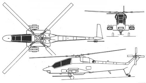

British armed helicopters

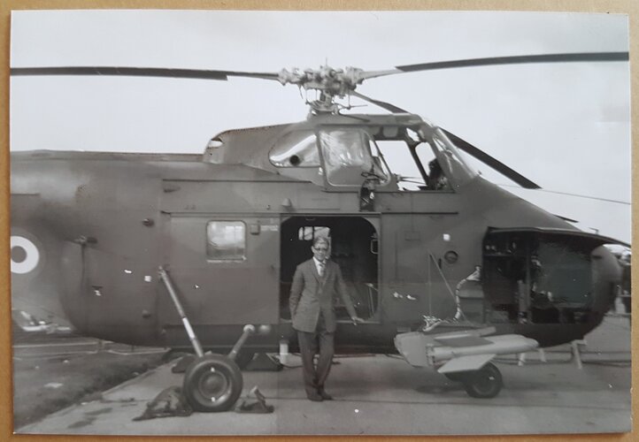

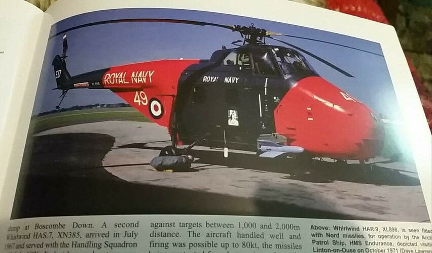

It seems that some Whirlwinds may have been armed with Nord SS.11s, according to this research thread on the WT Forums which I have taken part in:
It seems that a few of the helicopters of 225 Squadron, which operated HAR.10s, were modified to to carry SS.11 ATGMs according to the following sources:

Borneo Boys: RAF Helicopter Pilots in Action Indonesia Confrontation, 1962–66 by Roger Annett may show a Whirlwind HAR.10 with what may possibly be SS.11 launch rails above the landing gear, which is attached below.
Not sure whether these would be related to the JEHU, but it could be possible that these were lessons learnt which had been put into action.

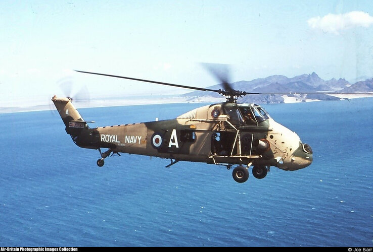

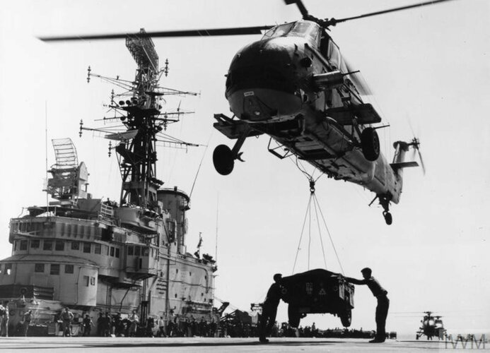

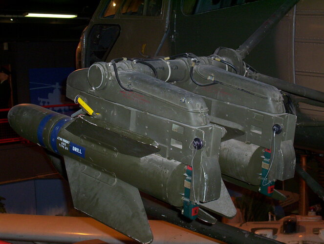

I do t have the book to hand right now but it does mention that the SS.11 installation was fully operational, not just for testing, and regular training was performed in Borneo firing the missiles against rock outcrops.

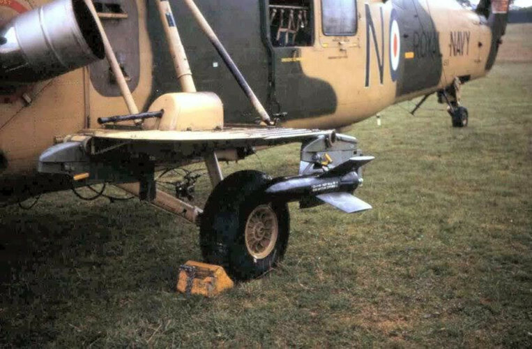

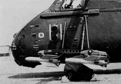

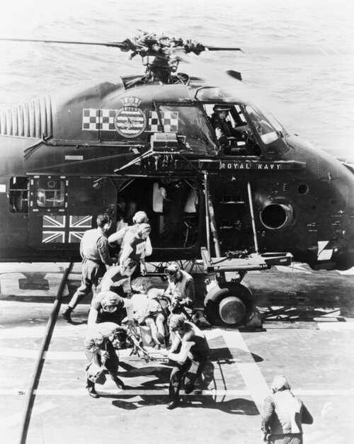

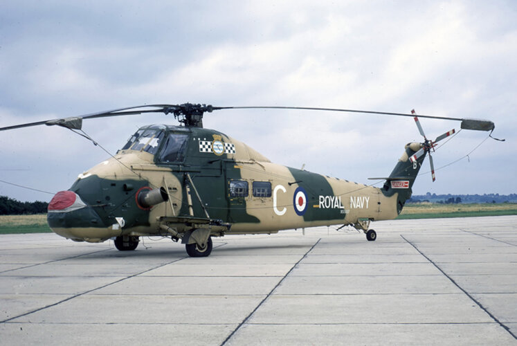

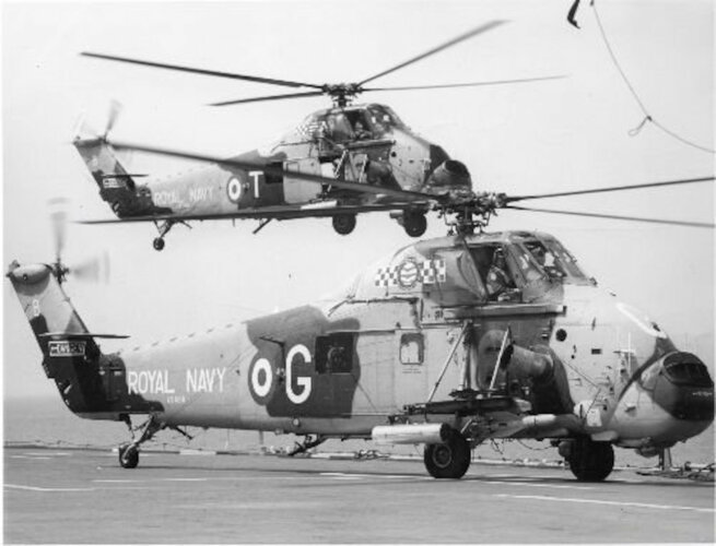

SS.11s, 2-in rockets, and Browning fixed machine guns were indeed operational armament, at least on the HU.5. Rockets and missiles were mounted underneath a flat platform braced to the landing gear and the fuselage. The guns were mounted on top of the platform. I have pictures of the guns both faired-in and unfaired.

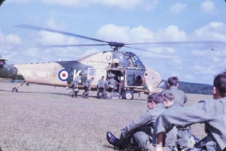

The pictures below show the platform installed on an aircraft at a base in Sarawak and operating from carriers. I also have an old book somewhere that shows HUs that are covering the evacuation of Aden and armed with everything: SS.11s, 2-in rockets, fixed Brownings, and GPMGs in the cabin windows.

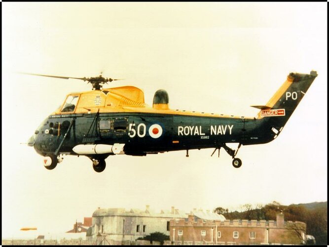

Next, a somewhat scarier armament fit, a WE.177 nuclear weapon on an HAS.3. As far as I can recall, this was intended as a feasability test for using the bomb as an ASW depth charge or for developing something similar specifically for ASW. But I don't really know at this point.
WE.177A was always in part a nuclear depth bomb; I'm not sure what platforms it was cleared for, but I expect this was part of trials for that role on the Wessex.

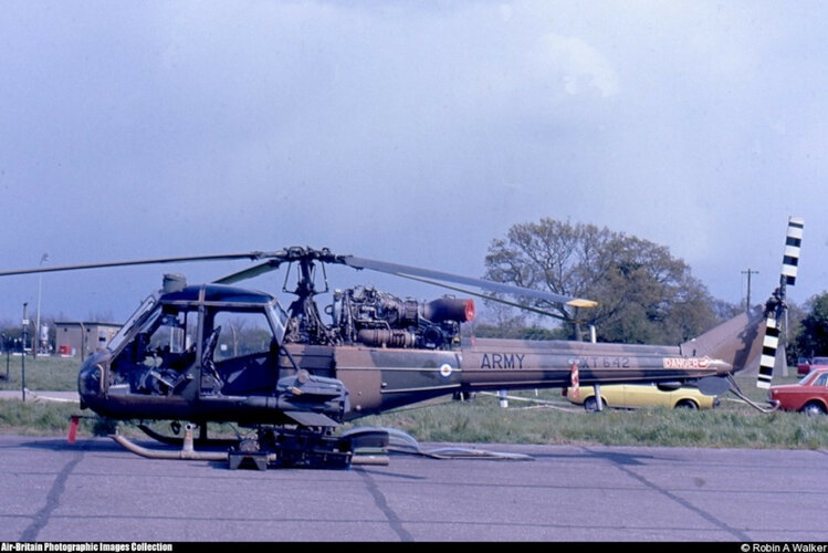

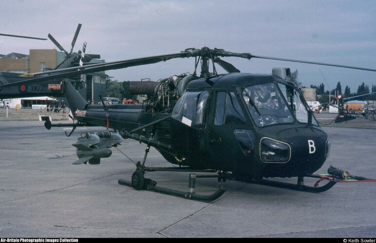

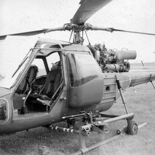

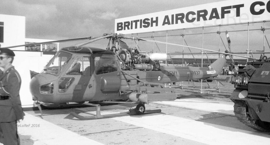

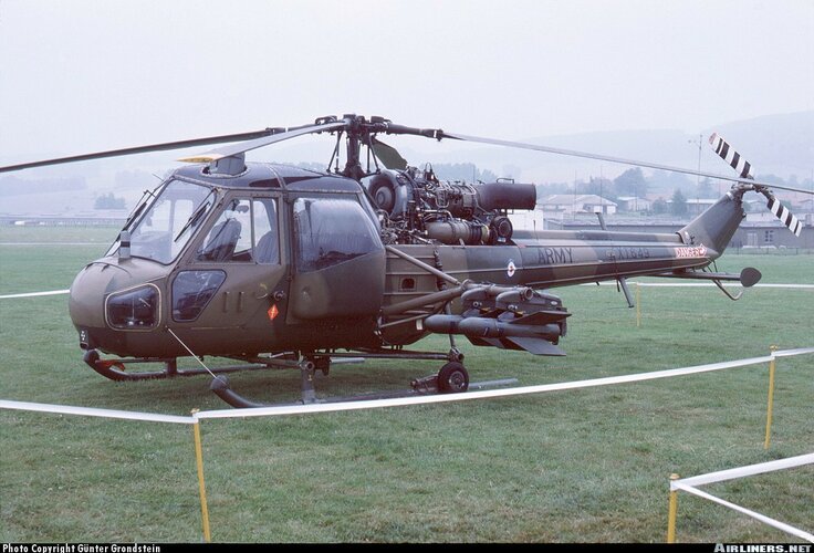

Images of Scouts armed with AS.11 are fairly common. I only have one showing a gun, a 7.62-mm GPMG fixed to the landing gear. I believe that they could also carry a similar gun on a pintle mount in the starboard rear door.

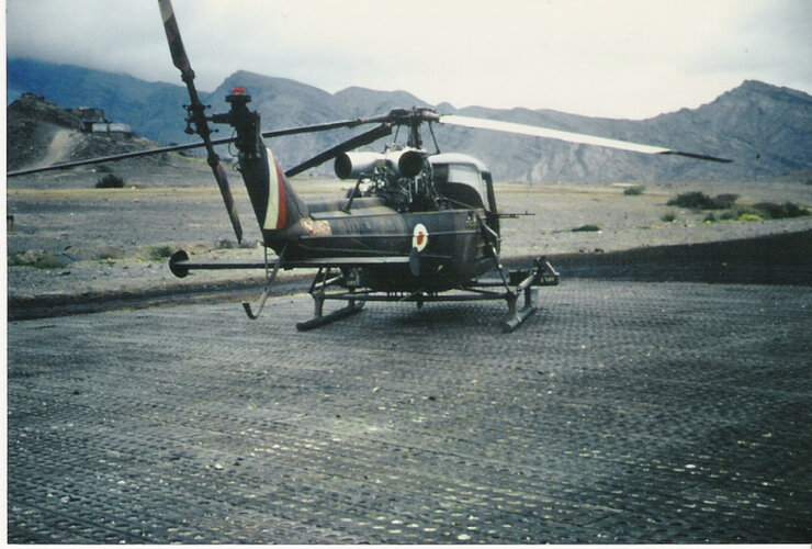

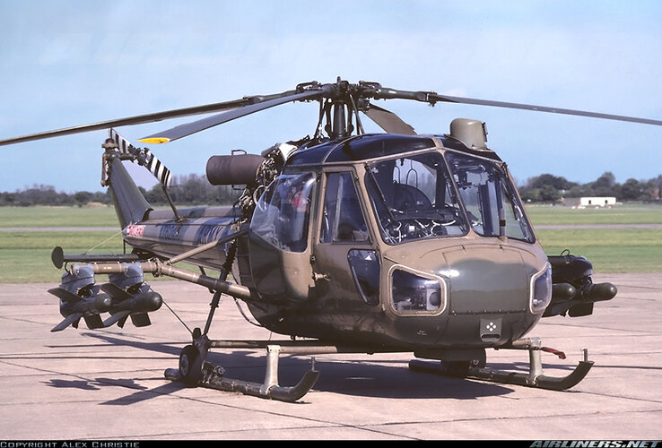

Here are an operational Scout with all three GPMGs installed and an exhibition example with four, boxy, faired rocket launchers ore missile launchers. Does anyone know what they might be?

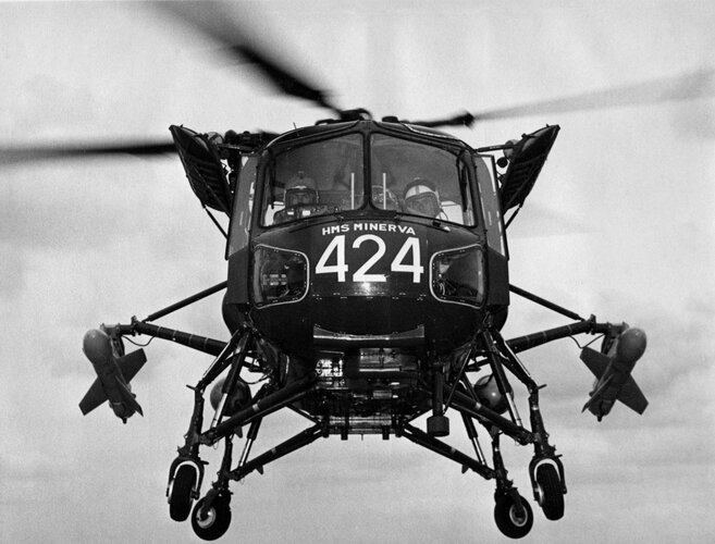

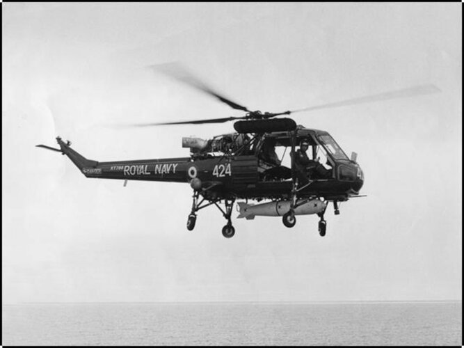

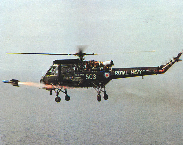

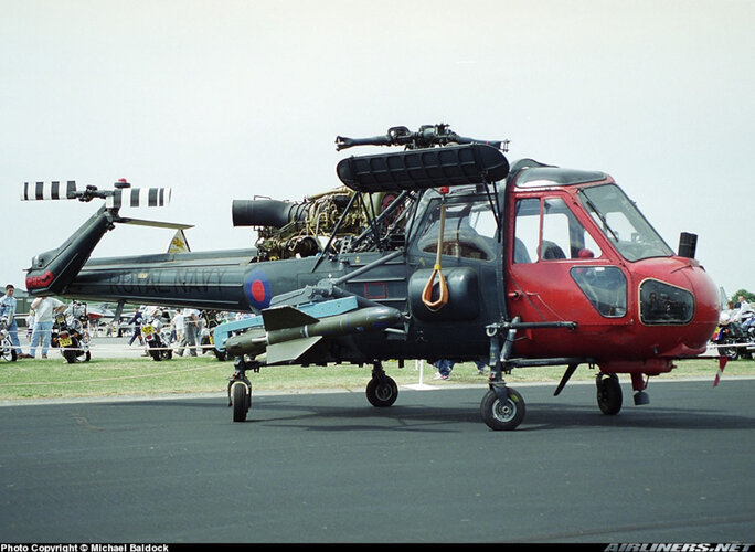

Finally, Wasps with the larger AS.10 anti-ship missiles, the SS.11, and the WE.177. The latter highlights the Wasp's size and load capacity.

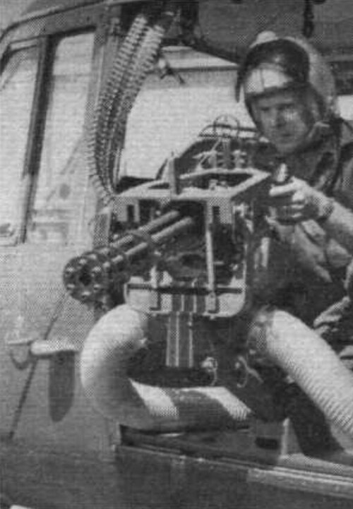

A page from Flight of a Westland Sioux AH.1 (Bell 47) armed with GPMGs in Belfast and a Scout armed, presumably experimentally, with a 7.62-mm GE Minigun, also from Flight (1968).
  • 1972 - 0049.pdf
