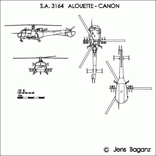

Apart from arming transport helicopters with pintle mounted machine guns and occasionally rockets, the first, more dedicated attack helicopter
I've found was the SA 3164 Alouette Canon, built in a single example,
as a moderate modification of a satandarrd SA.316, armed with up to
four SS 11 and a bow mounted 20mm gun.

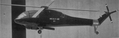

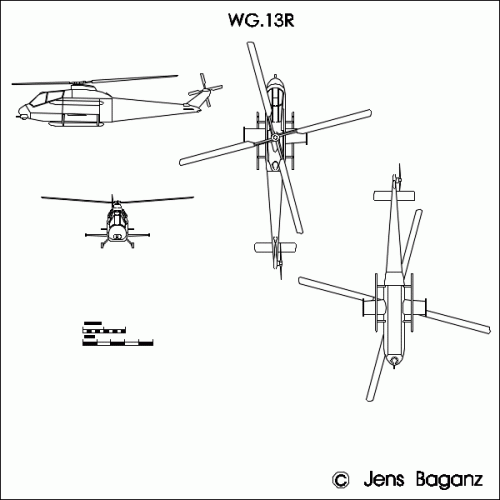

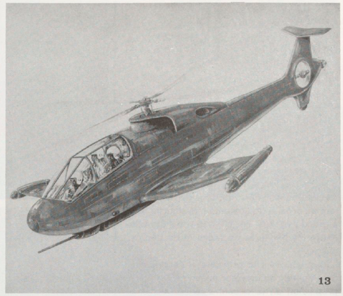

The anglo-french cooperation Aerospatiale and Westland brought several
projects for armed versions, which were intended for use for the french
army too. The layout of first armed version of the Lynx, proposed by
Westland in 1964, wasn't favoured in France, instead a cockpit with
side-by-side seating was adopted, although later designs featured
a tandem cockpit, too.
(from Aviation Week 5/68)

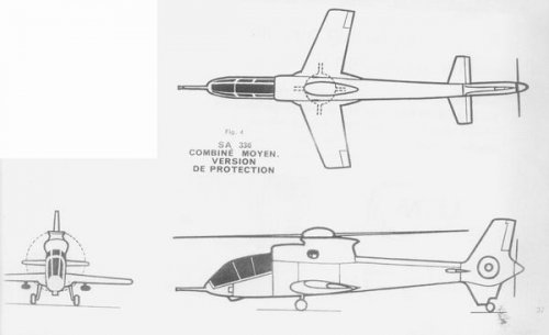

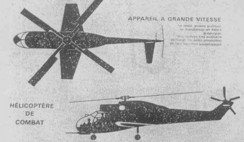

A concept proposed in 1964, based on the SA-330 Puma was the
AAFSS, using the dynamical system of the Puma, but fitted with
a swivelling tail rotor which acted at higher speeds as a pusher prop,
as in the Sikorsky S-61F (from FLIGHT INTERNATIONAL 1965).
As told in the AH-56 thread, I don't know if the concept from 1971,
based on the Puma was really influenced by the Cheyenne, or how
it fits into the french attck helicopter programs of this time.

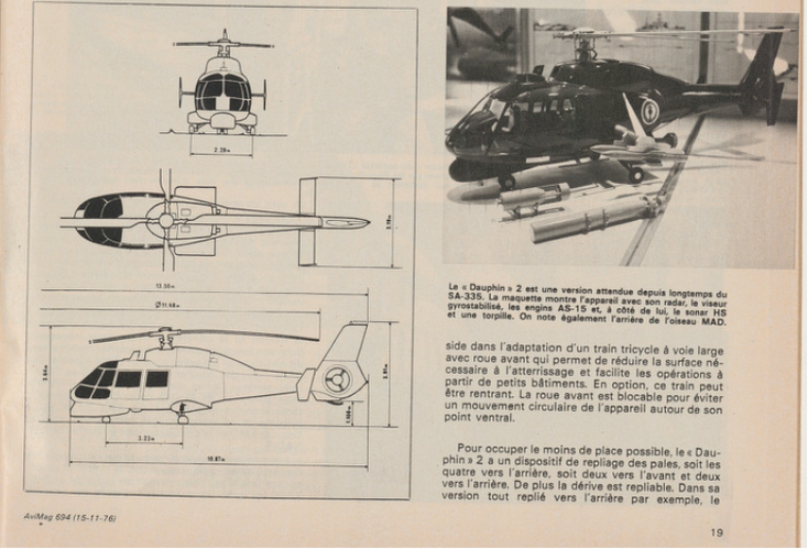

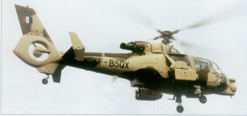

In 1972 a SA.360 Dauphin was modified to the SA.361 for the
HCL program (Hélicoptère de Combat Léger) (from MiniDocavia N°9).

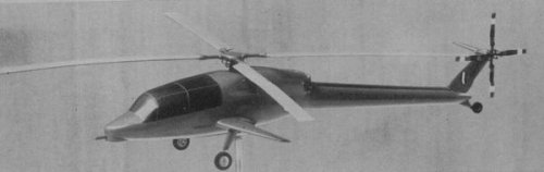

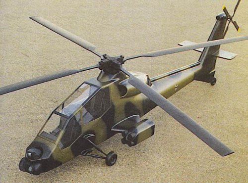

The beginning of the german -french collaboration, which eventually
resulted in the Eurocopter Tiger, brought several designs from Aero-
spatiale and the participating german MBB, later merged into Eurocopter.

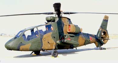

I find it quite amusing how much the front end of the Tigre with the fenestron looks like Italy's Mangusta.......
.. and the tail with the fenestron looks quite similar to the Kawasaki OH-1 !
A typically case of "form follows function", I think .

Re: Westland WG-13 French Attack Helicopter project......
Dear Boys and Girls, here is a feature in French about the Westland WG-13 armed attack helicopter "project" designed for the Armée de Terre. Is is part of a larger article about all the proposed versions of the WG-13......
The feature comes from the 15th September 1968 issue of Aviation Magazine International......
Terry (Caravellarella)
  • Westland WG-13 Armée de Terre version project - Aviation Magazine International - No.jpg
Very nice... but a Westland project in "French Attack Helicopters"?? This is misleading.
Maybe, but it's at the top of the topic and it was for a French requirement......
