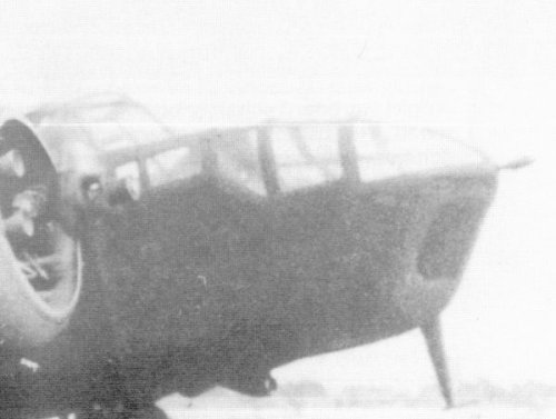

Some more input:
http://forum.1cpublishing.eu/showthread.php?t=2139
The plot thickens
The "doctored to appear to show a nose gun" image on
appears to me to be a reproduction with different contrast which makes clearer (or is doctored to appear to show - monoplane instead of biplane??) -the wing of an aircraft on the ground behind the Blenheim. It does look like a nose gun at a casual glance, but if so it's bent.
How about this?
http://images.google.co.uk/imgres?imgurl=http://samilitaryhistory.org/vo122jcb.jpg&imgrefurl=http://samilitaryhistory.org/vol122jc.html&usg=__ETMwWWFkBKPuBlFE76CcSpXkJ_Y=&h=204&w=320&sz=10&hl=en&start=101&tbnid=qaqlXOnl6uMO8M:&tbnh=75&tbnw=118&prev=/images%3Fq%3Dnose%2Bgun%2B%2522bristol%2Bblenheim%2522%26as_st%3Dy%26ndsp%3D18%26hl%3Den%26safe%3Doff%26sa%3DN%26start%3D90
but the picture is not too clear.
Thank you all,
I'm not convinced that the 'cannon' isn't infact the blenheim's own wingtip (although I want to be).
Here's another picture from the same article:
The aircraft has a belly back, but I can't make out a cannon (although there is a small chance it could be obscured by the people).

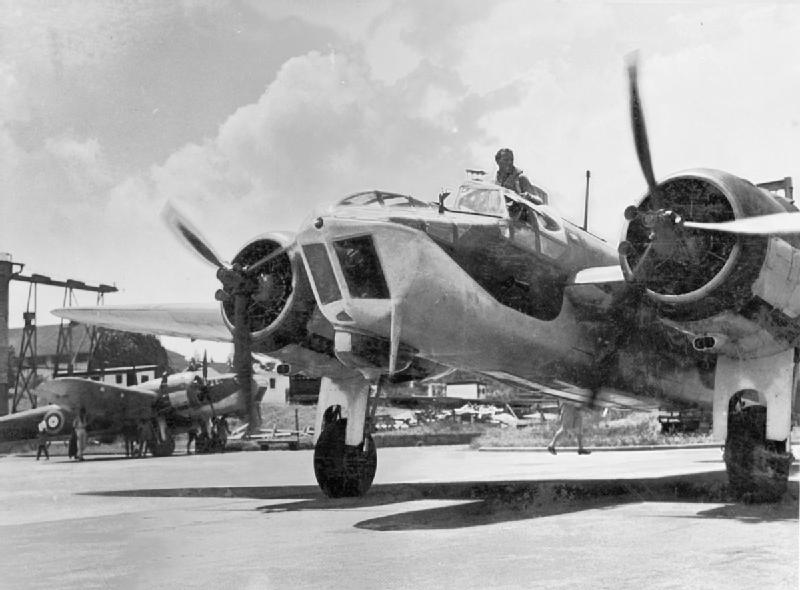

Here's a standard MkIV in a comparable position (but from Singapore in 1941 and without a belly pack):
So we have some historical reports of hispanos on Blenheims, an alleged case of photoshoping (which may in fact be simply an artifact), two pictures with projections from the nose of blenheims (but which may be the result of wingtips from either parked aircraft or possibly the same aircrafts and no clear answers yet. In other words fun! ;D
I wonder if we could track down higher resolution pictures or vets (the article mentions Eddie Hall as donating the pictures)...

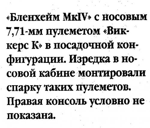

From airwar.ru:
Part of an image of a Mark IV with a nose cannon, and accompanying text - maybe someone can translate?

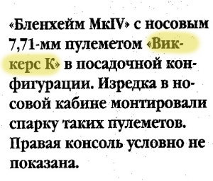

i don't speak or read russian, but from the shape of the gun in the drawing, and from some of the cyrillic characters, it's a Vickers K gun, a rifle calibre weapon, see:-
http://en.wikipedia.org/wiki/Vickers_K_machine_gun
cheers,
Robin.
That's an installation, that is shown in the Squadron Siganl issue about the
Blenheim, too, I think. Will post the picture this evening.
I don't read much Russian either, but I can definitely make out the "7.71mm". What an odd caliber, though.
Not bad - I've managed to display my ignorance both of Russian and of weapon calibres in the same post... ::)

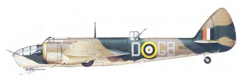

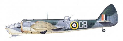

Foun some drawings
Nigth fighter with Hispano in the nose?

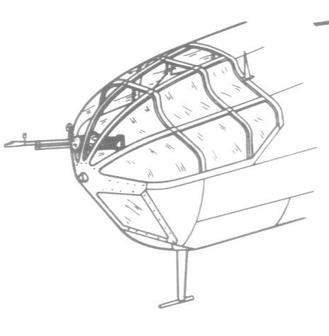

Here is a photo from the mentioned Squadron Signal N°88 and a drawing
of this installation. Another photo shows a Blenheim IVF night fighter
with an installation in the nose, that looks like the one on Justos drawing
and could be a gun. Unfortunately, it's quite a blurry photo and the caption
gives no clue about this detail.

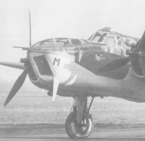

Now for some satisfaction:
Originally found by Docholiday;
Source: "The Bristol Blenheim"
Merv_P said:
From airwar.ru:
Blenheim MKIV with nose 7.71 mm "Vickers K" gun in landing configuration. Very rare there was a pair of such guns mounted. Right console not shown.
