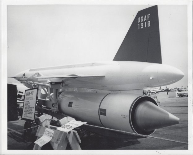

I just checked the 2707-300 general features PDF and it's showing ejector nozzles like the SR71.

With a cruise speed of M1.8, the Boom cone inlets are most likely external compression with a single oblique shock from the fixed cone and a terminal normal shock at the inlet annulus. These type of inlets don’t inherently unstart like the mixed compression M3+ inlets of the SR-71 and XB-70. The external compression inlets are efficient enough at M1.8. I did not think the variable ramp inlets of the M2 Concorde were mixed compression with the associated unstart possibility, but I could be wrong. But variable ramps can certainly malfunction and cause all sorts of flow anomalies to the engines.
The fixed geometry inlets can become unstable and develop inlet buzz if the engine airflow is reduced below a minimum level. Most fighter engines are set up so that power cannot be reduced below Mil power when above M1.4 for this reason. For a supercruise engine with no AB to turn off, this can be a problem - how do you slow down?
The F-22 has the inlet bypass doors on the top of the aircraft to maintain inlet airflow when the throttles are retarded and engine airflow is reduced below Mil power. I wonder if Boom is including this type of variable inlet bypass?
