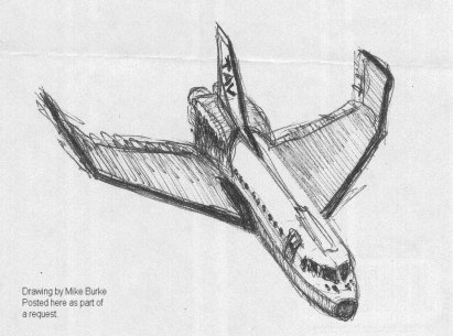

Back in 1985 Aviation Week ran a piece of Boeing art with an article on a White House Aeronautics policy. The art depicted what I took to be a transport TAV in Boeing house colors. This attachment is a drawing I did when I saw that article and I'm posting it here to support my question. Does anyone know if the painting was from a serious design study, or was this simply a "gee, wouldn't it be great if we could build something like this" picture?
Thanks,
Mike

There was a Trans Atmospheric Vehicle (TAV) program once but I don't know if Boeing was a participant - although it probably was.
Given that the majority of the fuselage was taken up not by propellant tanks but by a passenger section with airliner-style windows, my assumption has always been that it was pure propaganda, with minimal basis in engineering.
Really? It looks to me to be pretty similar in proportion to the Space Shuttle. They have simply changed out the payload bay for cabin space, admittedly the windows are a little optimistic but SS2 has shown that they arent beyond the realms of possibility.

The TAV program designed vehicles that, while not generally being SSTOs, were designed to be as reusable and as operational as possible, which generally meant no expendable stages. Thus the upper-stage spaceplanes needed to have a lot of propulsive capability on their own. Which meant that the vast bulk of their internal volume was taken up with propellant tanks.

Seeing this thread take off prompted me to go digging for the original image that I did that drawing from. (I don't have the best filing system - things get moved around depending on what I did with them last.) The rest of the article does not really address this design as it is about a White House policy Paper.
I had a feeling that this was a pie in the sky image because I remember thinking that there wasn't enough room for the engines and associated plumbing. Still, I thought it would be nice if a 3-view drawing turned up.
Thanks for your comments.
Mike

Anyway that drawing also remind me more a suborbital aircraft, like SS2 and so on, than a real orbital vehicle.
It seems to be a melting by a Space Shuttle and a McDonnell Douglas MD 80.
