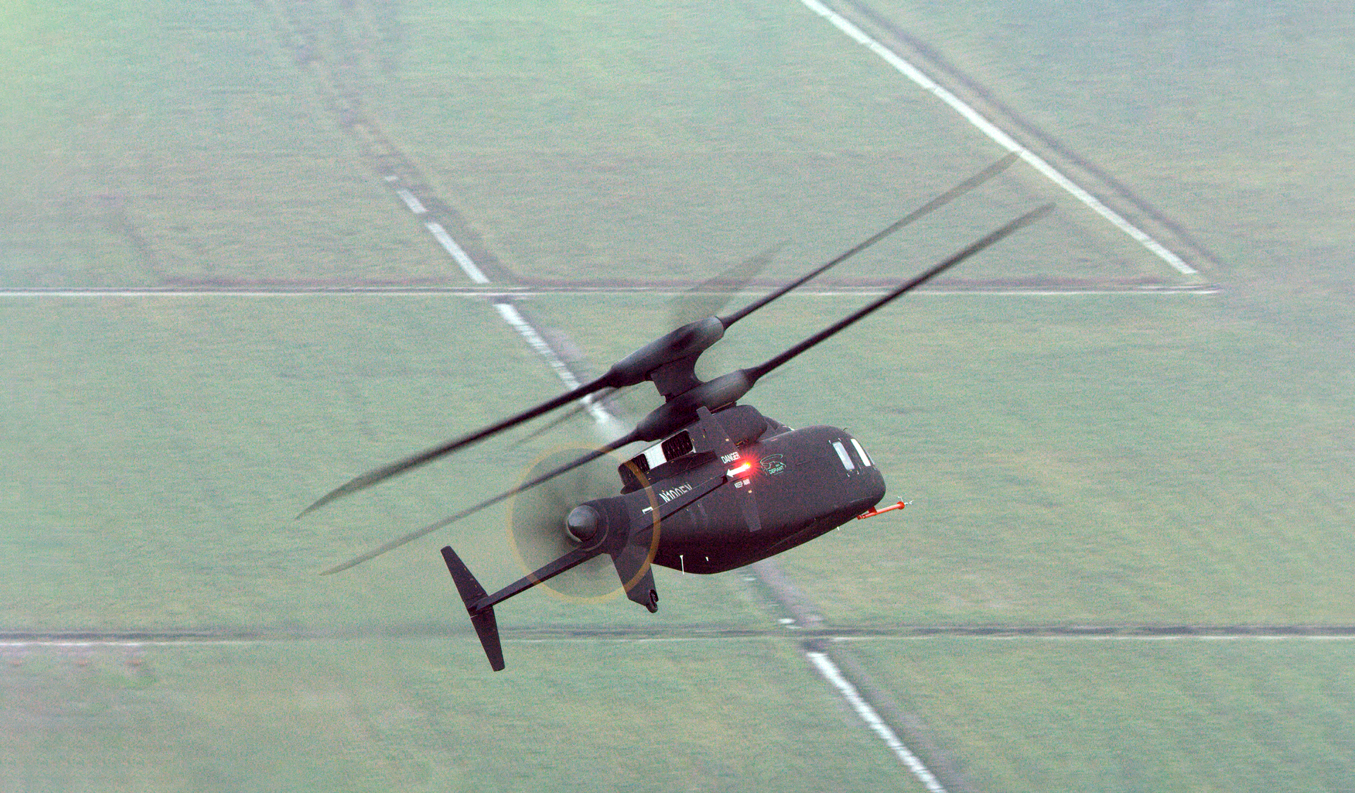

While the official JMR TD phase has ended, according to the Army, both Valor and Defiant continue to fly as each team works to drive down risk related to technology development that would ultimately help a possible program of record move more quickly down the road.
Even though the two demonstrators are in different places in their flight test plans, Maj. Gen. Thomas Todd, the program executive officer for Army aviation, said earlier this month that the service wasn’t planning to wait for each competitor to reach the same goal posts before proceeding. The only advantage a vendor might have in meeting timelines is that it is able to burn down risk in technology development, he added.
The Army is preparing to award an other transaction authority contract to begin a competitive demonstration and risk reduction, or CDRR, effort in March. An OTA is a type of contract that enables rapid prototyping. The CDRR will consist of two phases that last approximately one year each..."
https://www.defensenews.com/land/2020/01/17/defiant-exceeds-100-knots/
I believe they will get past 200 knots within the budget they have. Doubt they will get through a complete program to the depth that the V-280 did.

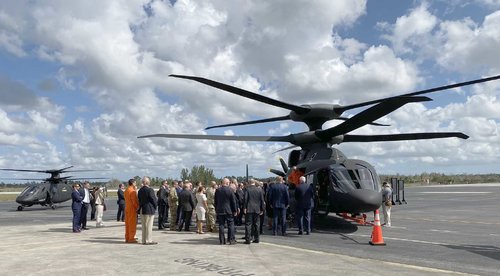

Both the Defiant and Raider are designed to fly at speeds of more than 200 knots, but they flew at slower speeds during the demo. The Defiant hit 140 knots, while the Raider reached 180 knots...
"When we are flying at 130 knots in this machine, we are using less than 20% of the prop power and less than 30% of the engine power," said Bill Fell, senior experimental test pilot for the S-97 Raider and the Defiant."
Test pilots on Defiant said they love the rear pusher-prop, which is designed to provide revolutionary thrust, but are also comforted that it can take direct hits in combat without causing catastrophic failure to the aircraft.
"It's all self-contained back here; you can take significant combat damage back here, and if you lose the prop, you are still a 150-knot machine," Ed Henderscheid, former U.S. Army AH-64 Apache pilot and Boeing's lead test pilot for Defiant, told defense reporters recently.
Unlike a conventional tail rotor, the rear pusher prop is completely electric, he said.
"Not having hydraulics in the tail boom as a helicopter pilot is a huge deal," Henderscheid said. "I have had hydraulics failures where they were caused by a break in the hydraulic line ... and it's scary when you have to go to keep your tail rotor where you want it. Not having to worry about a leak ... or some mechanical failure -- that's a really, really comforting thought."

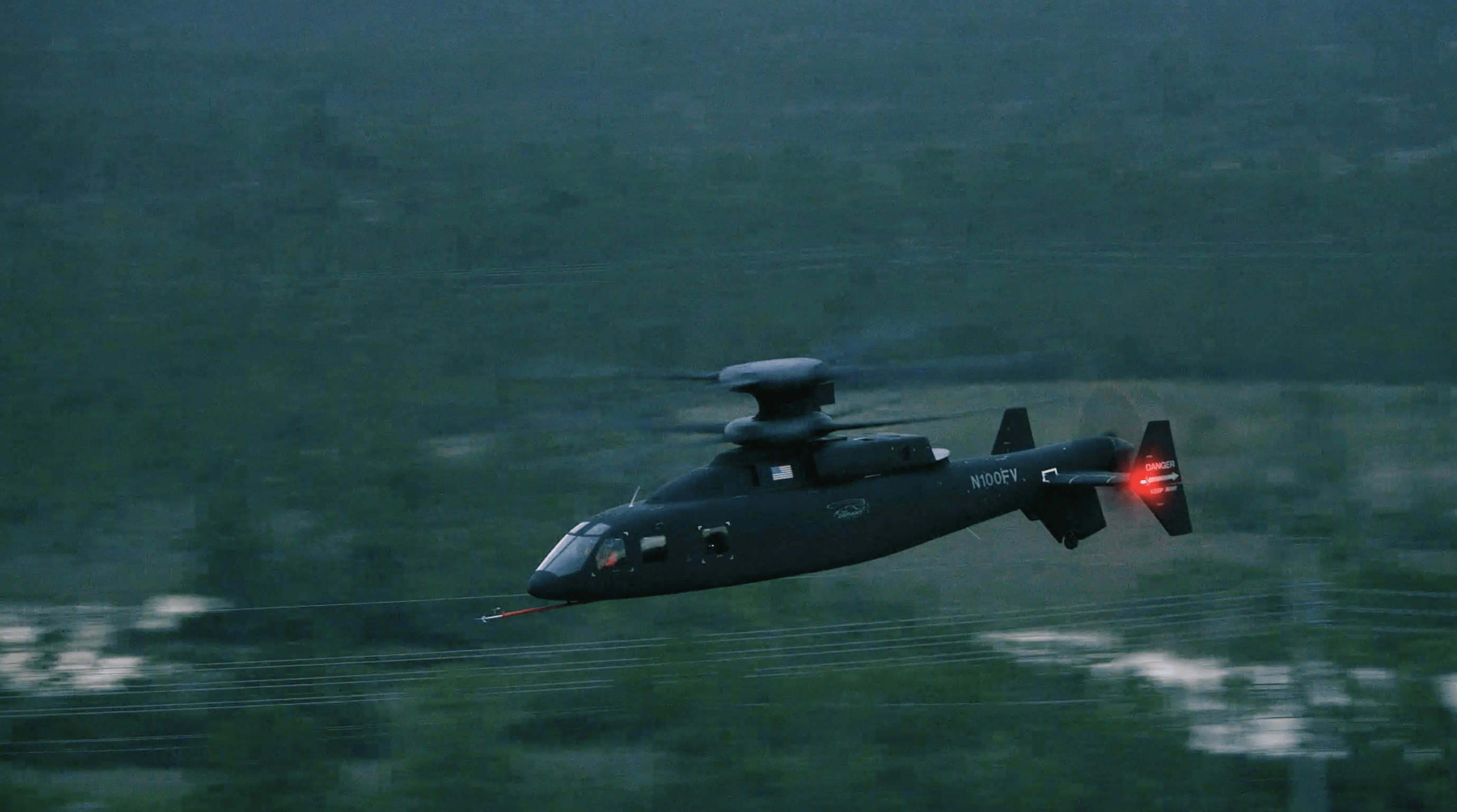

If you listen to the pilot's voice when they hit 200 it sounds like it's vibrating like a m'fer. One can't help but wonder what the vibration situation is like in the V-280 when it hits substantially higher speeds. And IF that is really the result of vibration we're hearing how much worse would it be when they go faster (in the SB-1 that is)?
I suspect both aircraft have robust vibration cancellation means. ~230/250 knots with rotating wings seems to me to be inherently vibratory.
If that is the case how do you account for the pilots voice sounding like he was talking through a fan?
https://www.verticalmag.com/news/sikorsky-boeing-defiant-zooms-past-200-knots-in-forward-flight/
Touches on vibration briefly: “Going 200 knots a lot of times in an experimental envelope expansion flight can be a little bit on the stressful side, but I gotta say I felt completely at home in the cockpit. The vibration environment was absolutely on par with other production model aircraft.”
That said, if this is truly only 50% available power to the prop, you can easily under why they are expanding the flight envelope and matching all the flight data to models in baby steps.
Well... maybe he is talking through "the fan" after all there are 16 fan blades on the beastie.
Seriously though, vibration attenuation has always been a challenge on ABC rotorcraft. I am not as well versed on how much tilt-rotors have to deal with this issue.
