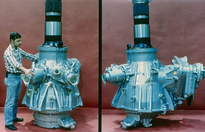

A turboshaft in the 7000shp class! And defiant has 2 of them...
Indeed lots of excess power that can be converted into lift and/or thrust as required. Btw, the turboshaft engines of the C-130 have a power output of ~4500 shp each.

A CH-53K has more HP than a C-130 and the same as the Mi-26 (22,500hp). (Though the Mi-28M bumped that up to a total of 27,600hp.)

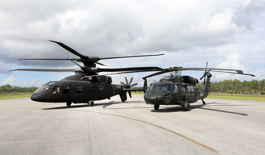

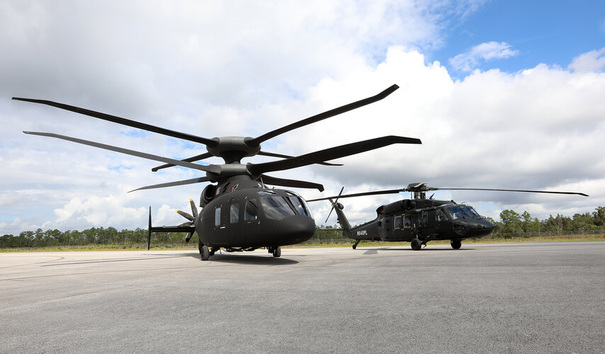

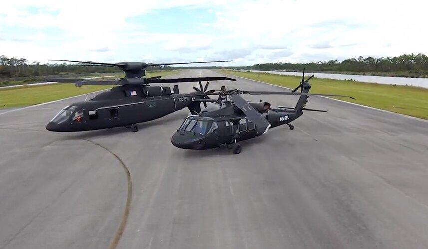

We'll see how that turns out. It's up to the customer... However, both teams have delivered impressive technology demonstrators so far. I would love to see a picture of them next to each other ;)
