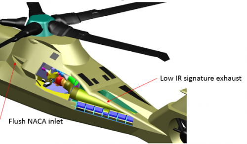

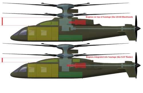

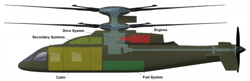

I've made a sketch of the internal layout, based on the video-snapshots:
There was one minor part missing... B)

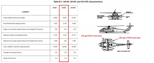

...I just noticed that the auxiliary fuel weight given in the table (3100 lb) would correspond to a 2x 230 gal fuel tank configuration (~0.8 kg/l). The 118 kts might be only valid for this config. Strange that the table says MAXIMUM auxiliary fuel weight ???
...another note: The internal fuel weight of UH-60 is 2350 lb (1066 kg) = 349 gal (1320 l). That corresponds to a box of 2m x 1m x 0.66m. Even twice the internal fuel would easily fit in SB>1's belly. That's why I was wondering what all the volume underneath the gearbox is used for.
Respectively there would be plenty of space to integrate the engines into the fuselage, lateral of the gearbox, as well.
Is there any military certification requirements that suggest the engines to be installed on top of the fuselage?
EDIT: I've attached a sketch to clarify my view

There is of course certification requirements for darn near every aspect of rotorcraft design for the government.. I suspect that the engines are on top of the airframe for aerodynamic reasons, to reduce drag, since the requirement is to make a fast rotorcraft. I also imagine there might be a weight consideration. To Jeb's point about access, I think that either method will give you fairly easy access, given the primary engine hatch will likely support the weight of a maintainer or two. Arguments can be made both ways as to how much ease of access you get with either configuration. I suspect that the fuel is right where you put it as putting fuel directly under the occupants has been undesirable to the Army for a long time. Since Sikorsky has put fuel aft in UH-60 to good effect, I imagine they are going to continue with a good thing. Having all that weight in line with the CG is probably a good thing to start a mission with. Although returning with a cabin full of troops and equipment and a light fuel load probably will require some extra work on the part of the elevators.

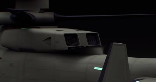

yasotay said:
...I suspect that the engines are on top of the airframe for aerodynamic reasons, to reduce drag, since the requirement is to make a fast rotorcraft...
:eek: I think the opposite is the case. Integrated engines would reduce overall height, frontal area and aerodynamic drag.
VTOLicious said:
Perhaps you are right. Perhaps Sikorsky will have integrated engines on top of the aircraft ;) I suspect that Sikorsky has spent a lot of time optimizing the airflow to minimize drag regardless of where the engines are.
yasotay said:
VTOLicious said:
It just came to my mind that there might be another reason:
As far as I remember the Westland G-LYNX had a special engine nozzle design to increase maximum speed. It can be assumed that the two T-55 engine will output a significant amount of thrust in cruise flight. When we look at the SB>1 pics we can see that the nozzles are very well placed to allow such a thrust augmentation.

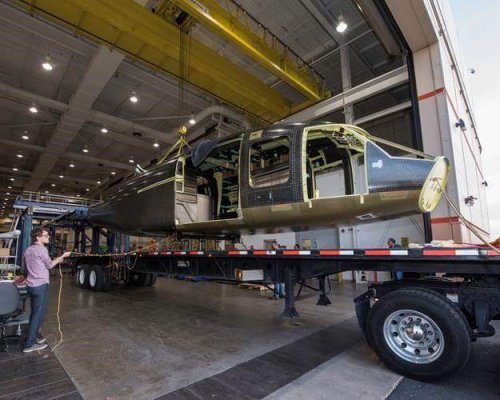

"Defiant’s delay due to blade manufacturing challenges"
by Jen Judson
September 11, 2017
http://www.defensenews.com/digital-show-dailies/dsei/2017/09/11/defiants-delay-due-to-blade-manufacturing-challenges/
LONDON — The SB-1 Defiant Joint Multi-Role demonstrator aircraft’s delay for first flight can be attributed to challenges in manufacturing its complex rotor blades for the helicopter’s coaxial design, the U.S. Army’s JMR program manager told Defense News at DSEI, a defense conference in London, on Monday.
“The challenge has been the manufacturing of the blades, which is an interesting challenge,” Dan Bailey said. “Some people would think that’s not technology but actually it is.”
The Sikorsky-Boeing team building the demonstrator for the U.S. Army announced it would not fly in 2017 as planned due unspecified problems.
Defiant is one of two demonstrators that will fly as part of the JMR program demonstration that will help define and build requirements for the Army’s Future Vertical Lift program of record expected to launch in roughly the 2019 timeframe. Bell Helicopter is building the second demonstrator – a tiltrotor design called the V-280 Valor. That aircraft will fly in roughly 20 to 30 days, according to Bailey.
One of the efforts underway by the Sikorsky and Boeing team for the JMR program is to design a future program that would make the aircraft more affordable. One way of doing that is to move from having people build the rotor blades to having machines that can handle the complex task.
To achieve the proper aerodynamics for a rotor blade, it “requires some very laborious-type manufacturing,” Bailey said. “They are done in a manner that is multi-sheets of composite material and they have to be laid up in certain patterns, certain directions, for strength properties and they do that pretty much today with people.”
The team instead decided to build the rotor blades with a process that uses a machine that lays up the material as it goes, Bailey said.
“The challenge with that is you have to have a tool that allows you to lay up that material,” he added, which is “a long, tube-like configuration and that machine lays up the composite material around it,” to create a rotor blade spar, the main structural part of the blade, Bailey explained.
The tool has to be “a fairly long piece of tool, it can’t have any sag, it has to be very dimensionally specific and structured and that has been a challenge,” Bailey said.
The team started with one type of material to build the tool and then switched to a different material. This alteration ultimately caused the delay.
“The good news about that is we have completely removed that risk,” Bailey said, because it is going to be the same process the team would use to build rotor blades in a program of record.
The team has built two spars using the new tool and the problem seems to be resolved, Bailey said.
Defiant is still on track to fly in the spring or early summer timeframe, Bailey said, but added that the time associated with building all the rotor blades for the demonstrator is about 10 months behind.

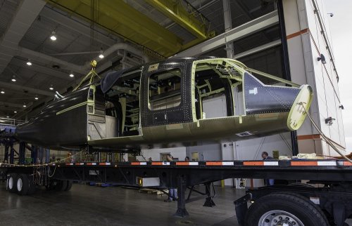

LM/Sikorsky is quite reluctant with news, especially regarding the progress of ironbird/prototype testing... Only one pic of the airframe appeared in December 2016, then silence...
