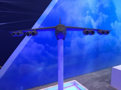

Stephen Trimble on Twitter:
And that’s what a B-52 looks like if you take off the TF33s and stick on (sorry about the technical term) eight modern turbofans.
https://twitter.com/FG_STrim/status/966995742597492737
