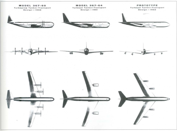

Boeing 367 Projects

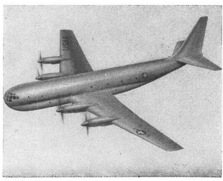

Note that the -64 has the wing-mounted, body-stowed landing gear. A major step towards today's civil aircraft.
here is an artist drawing to Boeing Model-367-64.
Boeing 747 Classic (Airliner Color History)

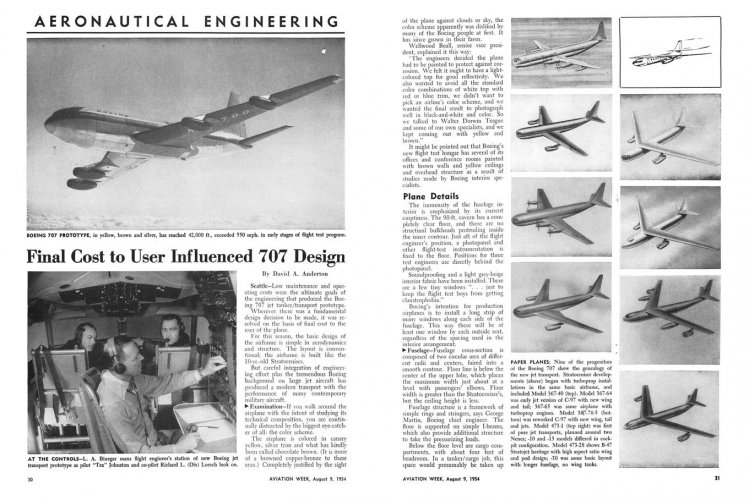

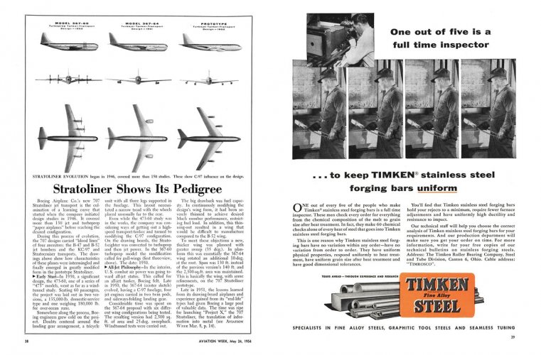

http://archive.aviationweek.com/image/spread/19540809/16/2

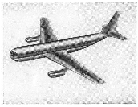

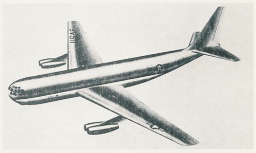

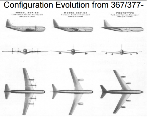

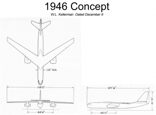

https://info.aiaa.org/Regions/Western/PacificNorthwest/Other%20Public%20Documents/2009%20Technical%20Symposium%20Presentation%20Sharing/Presenter%20Presentations/Session%20A%20-%20Skyline%20Room/Benito%20Almojuela/The%20Development%20of%20Boeing's%20367-80%20-%20Almojuela.pdf
Good PDF report Sienar,
and we can put them here.

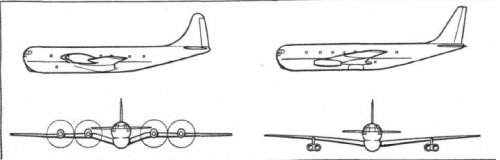

The legacy of the B-29 is quite awesome when you think about it. B-50, B-54, C-97, Model 367, Tu-4 / 75 / 80 / 85, the Guppies, the chinese Tu-4 AWACS with turboprops.
I just had the chance to read the volume American Secret Projects 2: US Airlifters 1941 to 1961 and on page 93 there is an illustration of 3 Boeing 367 designs with the same wingspan as the B-54: the Model 367-7-21, the Model 367-8-23, and the Model 367-14-25. As with the B-29/B-50, the Boeing company never spared a chance to consider modernizing the C-97/367 design with a bigger span.
