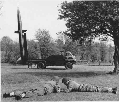

What do you mean by exhaust? There is an advert of the time showing it in the air just after take-off but it's not particularly of high quality.
Regards,
Barry

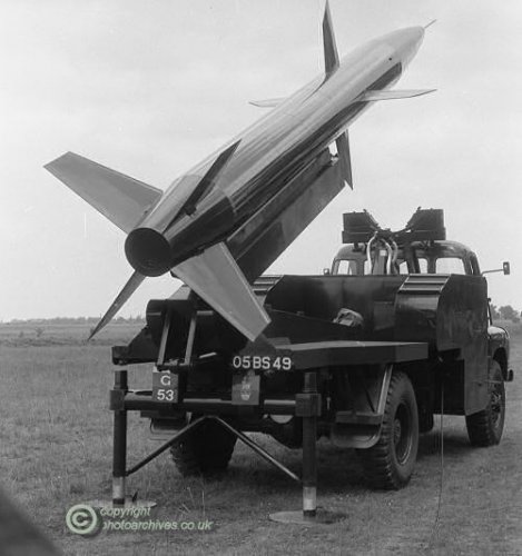

Yes, just the tail pipe. All pictures I have seen of the ground-launched Blue Water show it from the front, and all air-launched ones show it with a tail cone. I just like to know what the tail end looked like precisely (for 3D modelling purposes). The advert you mention might help.
aircav said:
Is this any good ?
Fantastic, 100% better than anything I've seen till now. Many thanks!
