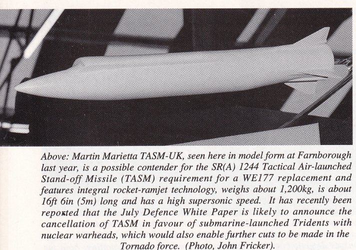

TASM Tactical Air-to-Surface Missile. To SR (A) 1244. WE.177 replacement. Cancelled 1993. R = 373miles

A bit of background on TASM:
TASM/US. Britain was evaluating a Martin Marietta system under a Memorandum of Understanding (MoU) signed in December 1989. Martin Marietta, which was teamed with British Aerospace/Hunting Engineering, was expected to offer a nuclear missile using integral rocket ramjet technology developed under its AQM-127 Supersonic Low Altitude Target (SLAT) and Advanced Strategic Air-Launched Missile (ASALM) programs. The ASALM effort was a US Air Force program aimed at providing an extremely long-range air-to-air missile for strategic aircraft (such as the B-1). The AQM-127A SLAT was a supersonic target drone being developed for the US Navy's low-altitude anti-ship missile simulator need. However, both these efforts were canceled prior to the start of production. Martin Marietta would have supplied parts to British Aerospace for final assembly and guidance system integration, with Hunting Engineering supplying nuclear warhead interface and perhaps contin-uing as part of the weapon integration team.
