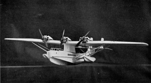

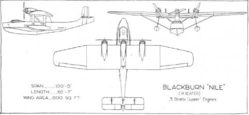

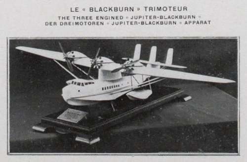

A desktop model of the Nile:

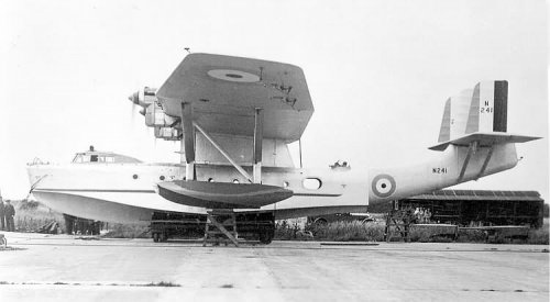

Two photos of the real thing from A.J.Jackson "Blackburn Aircraft since 1909":

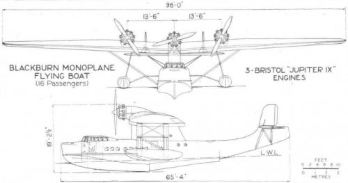

I’m sorry gents but this is incorrect.

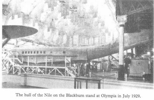

Blackburn built the R.B.2 Sydney to spec. R.5/27, not the Nile. The Sydney was flown and evaluated in June 1930, one of three prototype three-engined aircraft that were ordered at the same time (Saunders A7 and Supermarine Southampton X), but it did not receive a production contract.
The C.B.2 Nile was designed by Blackburn at the same time and was essentially a civil version of the Sydney powered by Bristol Jupiters. It was intended to use the aircraft on the Alexandria – Cape Town route by a new airline, Cobham-Blackburn Air Lines Ltd. The aircraft was nearly complete when the government vetoed the plans and insisted that all Empire routes would be flown by Imperial Airways. The Nile was never completed.

Ah, but it is in the Putnam book, it is project C.A.10 airliner submitted to Imperial Airways in 1928. This design was then modified as troopcarrier T.C.1 to specification C.16/28. However neither type is actually illustrated in the book, just described in brief.

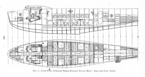

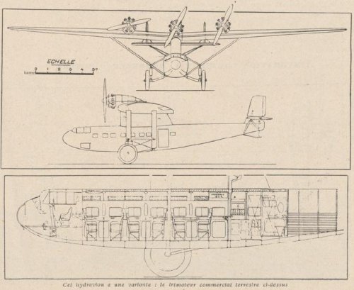

Another photo of the Nile model, a Blckburn advert, and cabin layout drawing

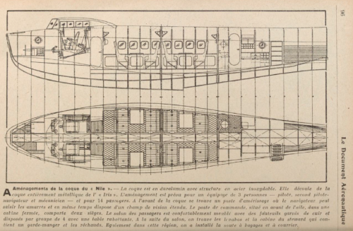

http://gallica.bnf.fr/ark:/12148/bpt6k9767475f/f584.image

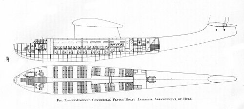

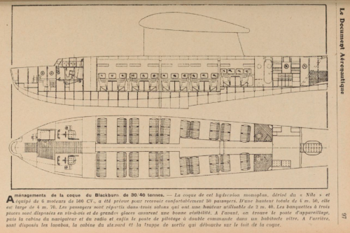

The second layout drawing is of a larger Blackburn project, a six-engine flying boat that was unofficially known as the Oceanic
Amazing Info,thank you Schneiderman,and please do you have a full drawing to it ?,thanks.
Yes, its on another thread topic somewhere too.

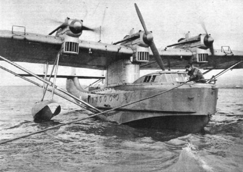

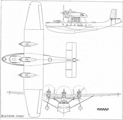

More Sydney and Nile pictures.

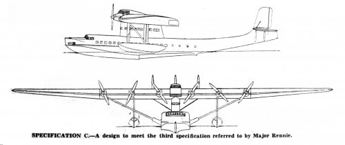

blackkite said:
What is bottom aircraft? Also Nile?
Well you could go back to the original source,which is Flight, and find out
Looking briefly in the Blackburn archives I see that the project actually started under designation C.E.2E and was included in the same technical specification as the Nile. For some reason the outer engines were on the underside of the wing, which led to complaints from the commercial department as it would not be interchangeable with that for the Nile.
