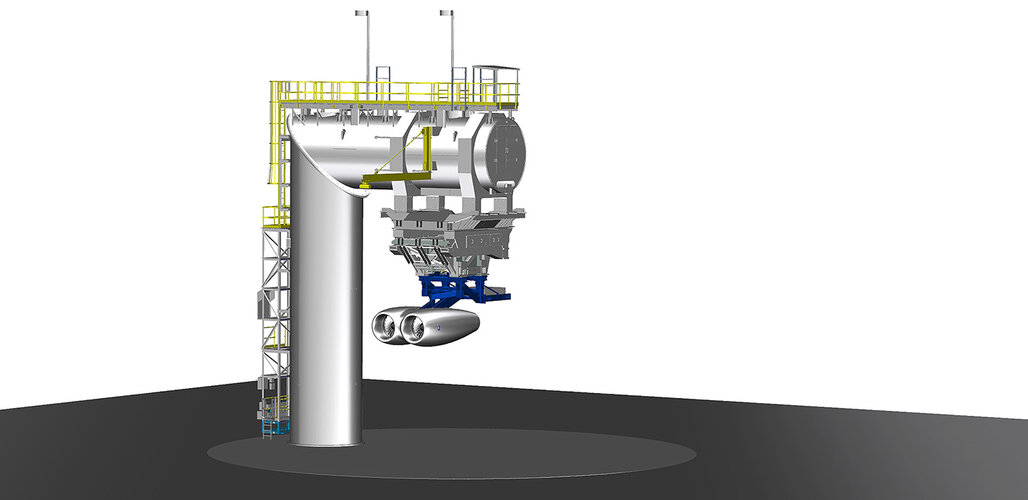

Interesting...full-length fan bypass in the nacelle. Implications there. Thanks @flateric, I missed that.

Nice bit of Deja vu, the new pod looks a lot like the old J57 pod.
Such as? Less drag? Heat exchangers? Something else?
The BR725 has a mixer at the back of the duct, helps with noise and a bit with drag
