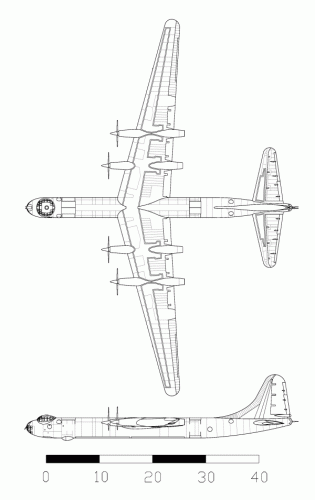

An illustration from the next issue of Aerospace Projects Review, showing a top & side view of a proposed B-36 variant with four turboprop engines. The article itself was written by Dennis R. Jenkins.
(Damn drawing took near two weeks to put together... mostly in trying to put together a decent drawing of the basic B-36, of which there are surprisingly few such drawings)

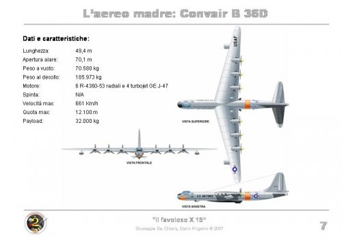

I had the same problem when I realized a 3-views drawing of a B 36D as mothership for NAA ESO 7487, for a presentation I did las November at AstronautiCon 2 (Italian Astronautical Convention).
