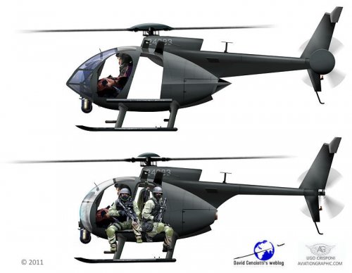

Thanks 500Fan, very in depth analysis. So conceivably with regard to the Little Bird airframe .....could it resemble what The Aviationist theorised ...
https://theaviationist.com/2011/05/25/a-stealth-little-bird/
In the 1998 Stealth Special of the Air Forces Monthly (Key Publishing)...in the section on RAh-66 and low observable helos....there was rumour about LHX competition and then MDH had tested a stealthy NOTAR but the Army picked the Boeing Sikorsky RAh-66 Comanche design instead. However officially as far anyone’s concerned the RAH-66 first flew in 1996.
I see a parallel with the Northrop B-21 and mystery triangles , Northrop won. So many a guess to see if the other OEMs must have built some prototype demonstrator ‘May the best man wins’.
The fighter like single seat fromBell-MDH team looks quite cool...as depicted by then MDH artists . This can be found in the late Bill Gunstons Future Warplanes.

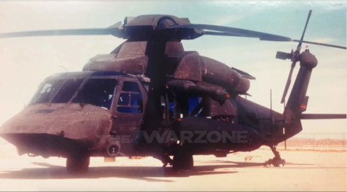

IMHO the picture shows a predecessor to the helicopter, which actual flew on Bin Laden raid in 2011.
the photo shows an YEH-60A at Edwards in 89/90 flight testing a “kit” modification. Half a dozen of the kits were produced. There were additional components to the kit not shown in the photo (tail modifications)
Mr London 24/7
Apr 27, 2008
407
93
The pic was posted and then swiftly removed from another forum some years ago (before the Bin Laden raid). The Test Manager posted some info about it there:
I was going to ask where you got that picture, but I know where it's from, as I was the test manager of that project and I had that photo taken. I hope you don't get into any trouble publishing this, as that aircraft was "sight sensitive" for quite a long time, and there are still aspects of it that are classified, although the external appearance is unrestricted.
I have numerous photos of this aircraft, but have refrained from sharing because of these concerns. At one time we had to take off 1 hour before sunrise and arrive back 1 hour after sunset so the aircraft was not observed.
What I can tell you is that is an EH-60A (the EH-60B was the SOTAS and there was only one) with the "Direction Finding Enhancement Kit" installed. There were several of these kits produced and fielded. At one time, it had a more extensive treatment applied to it, but parts were found to be unnecessary.
There were also similar kits produced for OH-58D's (there's a pic in Floyd Werner's book) and Apache's. It isn't too difficult to guess what the purpose of the kit is. After the sight sensitive restriction was lifted, we could freely park the aircraft on our ramp.
A Lockheed project was in the hangar next door, and a King Air full of Lockheed engineers came up from Burbank and parked on the ramp. You should have seen the looks on their faces when they got out and saw this aircraft!
We used to call this aircraft as the "Black Blackhawk", and the test team picture is amusing, as I had the photog double expose it with us in and out of the picture so we all looked like ghosts. This would be a real head-turner on the contest table.
I can talk a bit about helicopter RCS in general terms. As you might guess, the rotor system (and the rotorhead in particular) are the largest radar reflectors by a large margin. Also, you might be surprised at what levels of signature reduction can be achieved by treatments and coatings. There are also operational strategies that can be employed to reduce rotor system signatures.
That big fairing on the rotorhead was a real PITA from a maintenance and pre-flight standpoint, and tended to collect sand and debris.
When this aircraft was really sensitive, we had to do all our flying at night also.

And after the Bin Laden raid Tail wreckage images, the same chap:
As some of you on the board know, in my “previous life”, I was a flight test engineer and test project manager for the Army. Some of the work I did was in developmental testing of helicopter L/O technology. There is some information I can share with you (and a whole lot I can’t).
In the late ’80s, the Army began working on trying to apply L/O technologies to helicopters. Several applique kits were developed for a few airframes. This was in the early ’90’s. The ones I’m aware of were for the OH-58D, the AH-64 and the H-60. The OH-58 kit has been pretty well documented – there are pictures of it Floyd’s Walkaround book.
I was somewhat involved with the Apache kit and heavily involved with the H-60. I’ve never seen any information released on the Apache kit, and don’t know if any were ever produced or fielded. The H-60 kit was intended for EH-60’s and was referred to as the “Direction Finding Enhancement kit". The original kit had numerous appliques applied to the entire airframe.
There were some aerodynamic and vibration problems associated with the appliques on the aft portion of the aircraft. It was determined that, for the EH-60 mission, the frontal aspects were the most important, so the aft fuselage portions were eliminated.
Approximately five kits were produced and fielded (with the 101st), and I understand that at least 3 were deployed during Desert Storm. The word we got was that the kits were a maintenance headache, and portions were removed in the desert, and use of the kits was abandoned shortly after. I have also heard rumours that further development of the kit continued.
The kits were developed by Sikorsky. The aircraft was originally ‘Sight-sensitive” for quite some time, and we had to perform much of the testing at night, or at remote, secure locations. Eventually, the restrictions were lifted and we were allowed to park the aircraft on our ramp without restriction. At that time, the YF-22/YF-23 fly-off was underway, based at the hangar directly across the ramp from us. Lockheed would occasionally fly engineers up from Burbank in a King Air. The look on their faces when they got off the airplane and saw the EH-60 (which we nicknamed the “Black Blackhawk”) was absolutely priceless!
What I see in the pictures appears to be a refined form of the original “DF Enhancement” kit. The shapes are similar to, but smoother than the original appliques. The forward swept stab is new – we did not have it in the original. I have no idea if this is an applique kit, or whether there were actually MH-60s produced this way in a permanent configuration. Frankly, I’m fascinated to see these pictures, as I had no idea that they had actually continued to develop and field these kits.
Besides shapes, a component of L/O is coatings, and the silver paint on the stab is very likely similar to what is applied to F-22’s. I suspect this is an advanced form of RF absorbent paint. I can’t tell you exactly what it’s composed of (and I’m sure it’s changed from what we used to use), but i can tell you that it incorporates various heavy metal particles that essentially convert RF energy to electric currents and heat.
As Jon says, ‘helicopter’ and ‘stealth’ don’t belong in the same sentence, but I was honestly astonished by the amount of signature reduction that could be achieved simply by shapings and coatings. Obviously, I can’t give numbers, but they are on an order of magnitude.
There are additional, advanced technologies that I still can’t discuss (some were applied to Comanche, some weren’t) that can achieve even more significant reductions. Although you probably can never achieve B-2 levels of stealth, I think you would be honestly surprised at how stealthy a rotary wing aircraft can be.”
Note that he refers to the ATF Flight Test team being nearby: chiming with Quellish’s recent comment in the Mystery Aircraft Thread: for the doubters.
