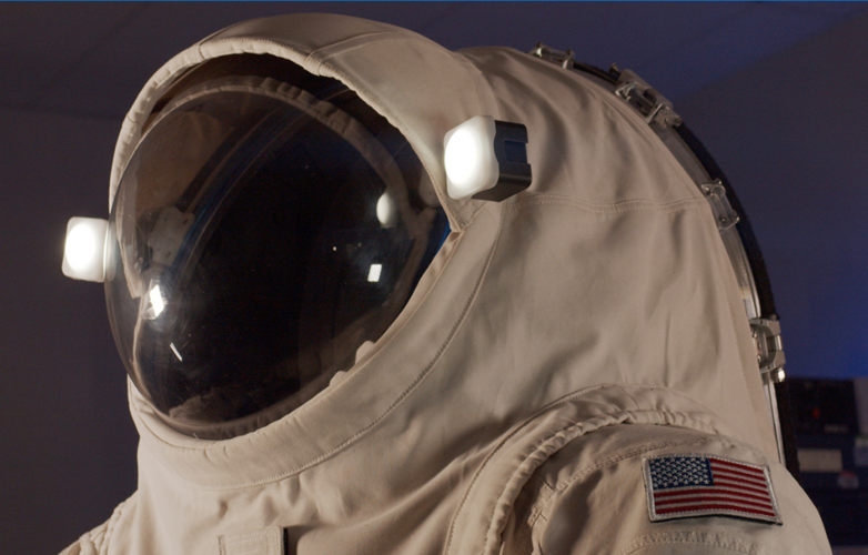

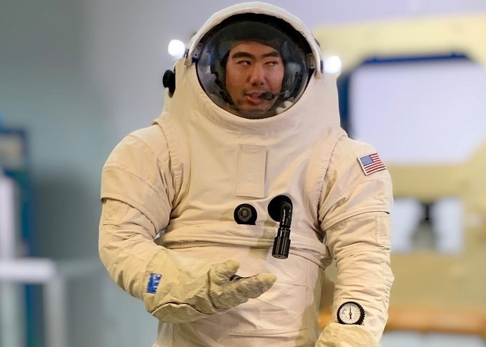

Paragon seem to be deeply involved on the Axiom team. They've been using these photos to illustrate their press releases; not sure if it's an old suit or something specific to this contract, though. In the close-up, you can see it's a rear-entry suit like the Russian designs
Paragon Announces NASA xEVAS $3.5B Award as Part of Axiom Team
/PRNewswire/ -- Paragon Space Development Corporation (Paragon) is proud to announce that it is part of the Axiom Space team which was awarded NASA's...www.prnewswire.com
I hope it is not.
The breather tube just in front of female astronauts boobs and the rigid torso link at the same emplacement (inherently determining who can use the suit or not) would logically dictate the lead engineer of this team to be spanked to orbit...
Honestly, how can those things pass a single design review?!?
I hope it is not.
Teenagers are running the show now. If it didn't happen in the last 20 years, it didn't happen. Besides, those in charge are telling them the most important thing to them: Make sure it doesn't look like the old stuff. Perhaps the designers and engineers should be put on another project: redesigning the wheel. Note to management: Take away their dumb phones during work hours.
I hope it is not.
Let's not pretend that the old guard never screwed things up. The "olds" are the ones who designed and bought suits that can't actually be worn by all astronauts, after all. And it's the new guard who are pushing to make sure the new suits actually fit astronauts, male and female.
I'm the high side of 50 myself, but the one thing I've learned in my decades is that young people can be at least as smart as me (and I'm not an idiot) and often come up with ideas experienced people would never have considered. Now, sometimes those ideas are dumb for reasons that experience can immediately spot, but quite often, they're better than the old ideas that have been hanging around too long and are overdue for re-examination.
Now, I don't know anythign at all about this specific suit, but I do trust that there will be some serious attention paid to fitting as many people as possible, because we want to make sure the talent pool is as wide as possible and not limited by who fits in the stupid spacesuit best.
