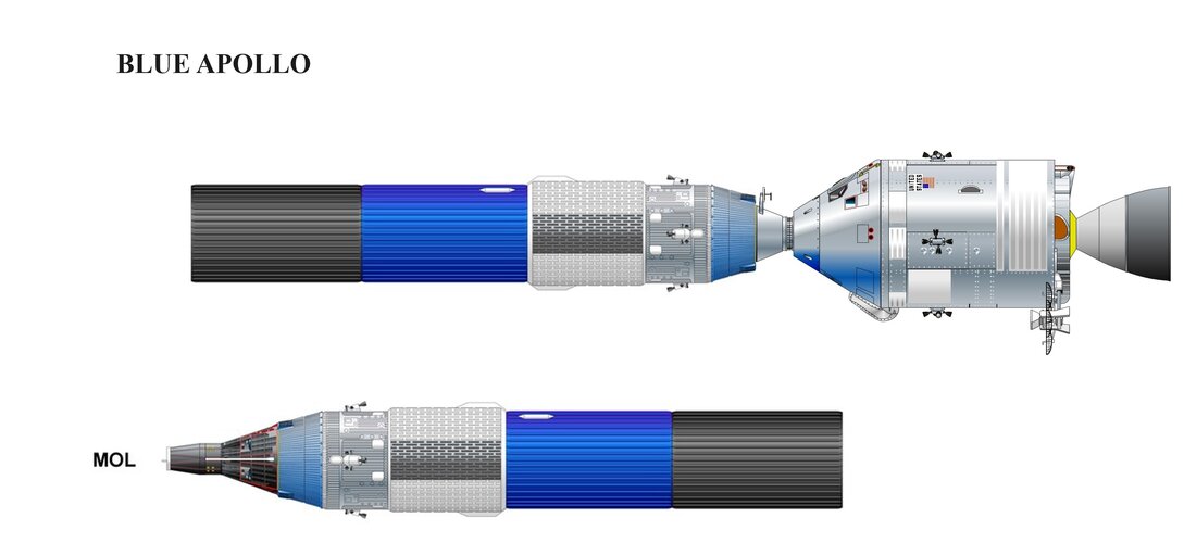

The unmanned MOL would still be launched from Vandenberg. Either from SLC-4 or the brand new SLC-6. No crew, no Gemini-B, but film return capsules. https://en.wikipedia.org/wiki/Vandenberg_Space_Launch_Complex_4#Titan_IIID
A "man tended" MOL (with a docking collar for Apollo and the pressurized module for the crew) would later launch the same way. It is far more practical to launch in polar orbit from Vandenberg than The Cape.
Now, the Apollo man-tended MOL missions. Problem: no Saturn pad at Vandenberg. The only way is to launch into polar orbit from The Cape CCAFS by making an ascent "dogleg". To avoid dropping bits of rockets either on the East Coast or the Caribbean.
For NASA: problem is that a MOL even without the huge camera is still much heavier than the ASTP module. So separate launches: MOL module from LC-40 /41, Apollo from LC-34 / 37A or 37B, nearby.
Note that NASA space stations / AAP missions don't go to polar orbit so the dogleg might not be necessary. The module is a "man tended MOL" except without the classified, huge camera - mking it 12000 pounds lighter (from a declassified AAP / MOL document). Instead of spysat cameras, maybe there are cameras borrowed from reconnaissance planes, as done for the later Apollos around the Moon (LTC, PanCam).
From 1969-70 NASA procured a handful of Titan III (8 of them) for the ATS-F comsat and later, Centaur missions: one test flight, two Helios, two Vikings, two Voyagers.
