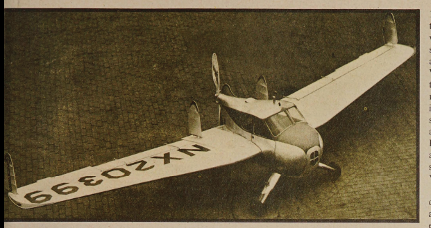

Similarly it mentions the Tuscar as a pusher monoplane with 95 hp Menacho engine. There is a little about the Tuscar (including some photos), which seems to have been modified from H-70 to H-71 types during its life, at http://aerofiles.com/_ti.html :
"1937: Management & Research Inc, New York NY. c.1939: Tuscar Metals Co Inc.
"H-70, -71 1937 = 2pClwM; 95hp Menasco B-4 pusher. Thomas Hoff, derivative of Stearman-Hammond Y. Tailless (except for wingtip rudders), flying-wing design with rudders mounted at the trailing edge and trailing-edge flap-type controllers. POP: 1 [NX20399], originally built by Management & Research under a DoC program contract for lightplane development, it did fly, although difficult to turn, but crashed in testing 1/27/38. Rebuilt by Tuscar as H-71 and flown at Floyd Bennett Field for about 60 hours before crashing to finality in Aug 1945."
