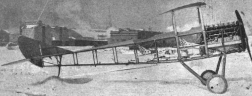

M.F.P. Biplane Construction Techniques
The structure of the M.F.P. biplane was comprised mainly of steel tubing which was assembled on jigs. The fuselage frames were not welded together but, rather, were assembled much as a wooden framework would have been -- following the structural precedent of M.F.P. co-owner, Walter L. Fairchild (see first entry). This approach required specially-designed, bolted 'clamps' to couple sections of cut steel tubing together. For economy, these fuselage frame clamps were made interchangeable. Once the steel tubing was joined, the structure was braced with crossed wire much like a wooden fuselage.
The biplane's cabane struts were extensions of two sets of fuselage frames. Special saddles were designed to hold the upper wing spars. The wings were of a conventional, two-bay, strut-braced arrangement. Despite some journalistic claims of an 'all-steel' airplane, the M.F.P. wings were of mixed construction. Built around twin 2-inch steel-tube spars, all ribs and bracings were wooden - spruce formers with laminated birch/gumwood webs. When fabric-covered, the whole formed an Eiffel 36 section - like the Curtiss 'Jenny'.

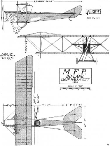

-- http://flyingmachines.ru/Images7/Flight/1916/506-1.jpg
M.F.P. construction techniques were said to use "little or no welding" but I have found no detailed description of how the tailplanes were put together. In the Flight 1916 'in progress' photos, the tail surfaces are already fabric-covered. The tailplane (and aileron) structures may have been made of wood or of clamped steel.
The aim of these construction techniques was to provide a lightweight framework free of "warping or twisting" and "unaffected by climatic conditions". Such a frameswork, it was claimed, would be of "great advantage for military and naval service" since it could "be left exposed for months at a time." [1] Should the airframe be damaged, components could be "replaced by standard pins and bolts." [2]

The airplane built by at Polson Iron Works in 1915-1916 was the large-span M.F.P. Model B. Why this type was designated M.F.P. B-2 is unknown. That '-2' suffix may refer to the prototype Model B being fitted with dual controls (of Deperdussin type) ... although this numeral suffix is not seen applied to other 2-seat M.F.P. types which were also offered with optional dual-controls.
Of conventional layout, contemporary sources compared the appearance the M.F.P. biplane with that of the Curtiss 'Jenny'. [2] The similarity in tailplane shapes is most apparent. But the distinguishing feature of the M.F.P. biplane was its steel framework. Unlike other M.F.P. 2-seater designs, the Model B had unequal span wings - the top wing spanning 45 ft. 10 in., the bottom 34 ft. 4 in. - with a wing area of 410 sq. ft.

I found the attached drawing of the "B" in my files.
Thanks iverson.
A 3-view drawing of the M.F.P. Model C accompanied C.W. Thomas' 1959 Aircraft article 'The Polson Iron Works Biplane: A very rare bird indeed'. Alas, I cannot scan it (thank you Microsoft!).
