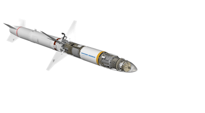

So, Northrop Grumman has advertised a ground-launched containerized launcher for AARGM (advanced HARM) or AARGM-ER. It presumably needs a booster of some sort but it seems like a relatively easy modification, especially if they've already been studying it.

The Supersonic Air Launched Target (SALT) is a specially configured high-speed anti-radiation (HARM) missile system, that incorporates a modified Advanced Anti-Radiation Guided Missile (AARGM) Control Section, inert HARM AGM-88B Guidance Section (ballast), HARM Telemetry (TM)/Flight Termination System (FTS), and a HARM-B Rocket Motor. SALT provides an affordable air-launched supersonic target that will be used to test the effectiveness of shipboard air defense systems and warfighter training operations against a supersonic threat.
