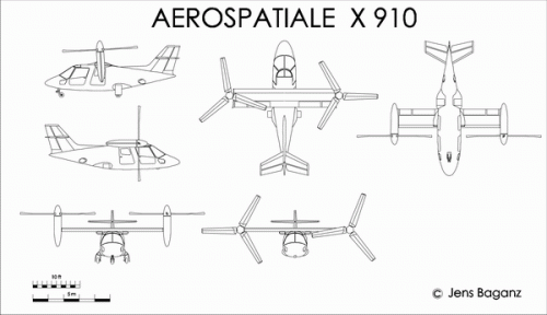

Aerospatiale study in the 70' a tilt rotor program, the X 910. It was only a "paper plane", but the rotor was tested.

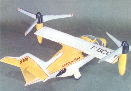

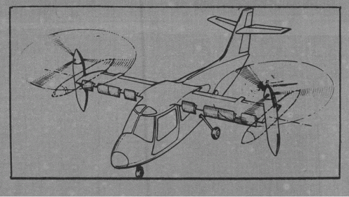

I have this little drawing from Aerospatiale
(Well, I find a good photo on the Rotojet project). Will post it !

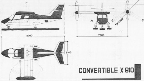

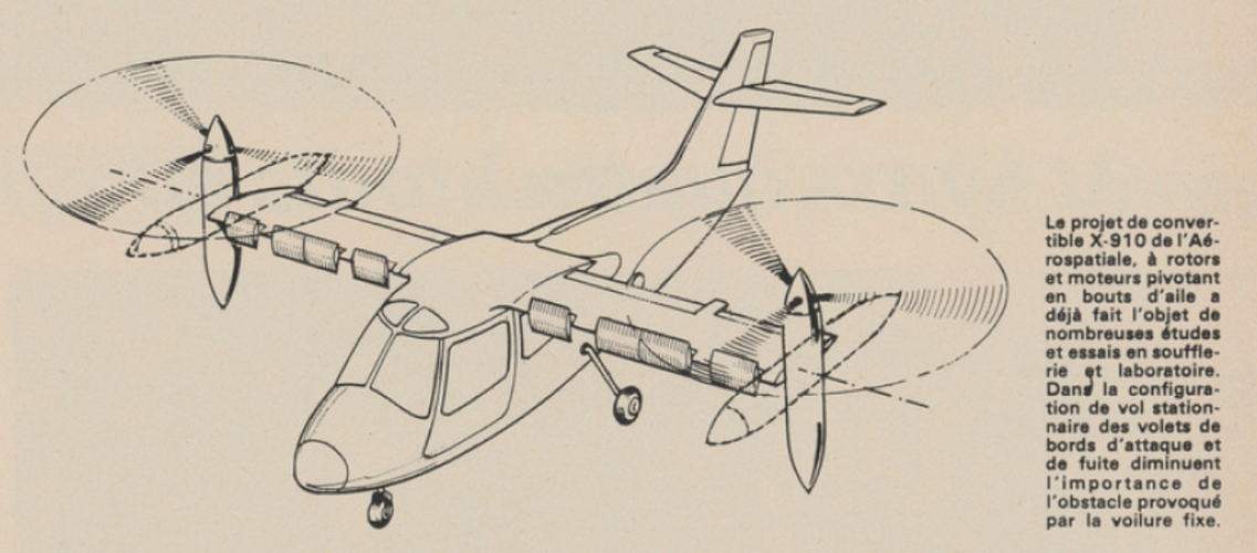

In InterAvia (sorry, didn't wrote down, in which issue ) I once found a drawing of the X-910,
which seems to depict it with a fixed landing gear. Another interesting point, I think, are
the slats, shown deployed in this drawing.

Hi Jens
Yes. It seems that it is a fixed landing gear

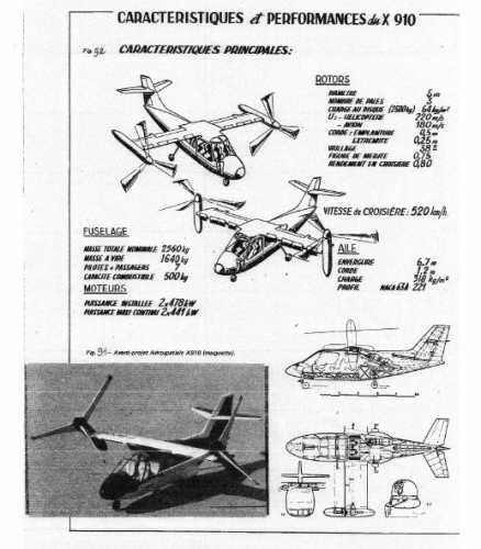

the Aerospatiale X.910.
L’histoire des hélicoptères
en France
depuis 1945

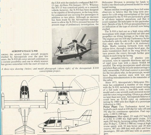

Further to the previous posts, here's the entry regarding the Aerospatiale X-910 from the Air Data section of the June 1977 issue of Air International
