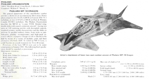

You are right Bgray,the MP-36 from JAWA 1985.
The keyword is "promise".
Moody, the boss of Phalanx, hired himself a persistent and thoroughly annoying PR guy with an unerring eye for the less technically adept members of the media. As a quick scan of the JAWA entry will show, somehow Moody planned to achieve a 2200 lb OEW with >1200 lb in bare engine weight, not to mention hitting Mach 2.5 with an unreheated 2:1-BPR engine. (Aside from the fact that the engines would melt, at M=2.5 the bloody canopy would use up most of his airframe mass.) In one of his interviews, Moody bragged of working with both Teddy Petter and Willi Messerschmitt.
JAWA, at the time, had a policy of not judging the credibility of new-start projects. It didn't always serve them well. I had to write intemperate memos in all directions to keep the publication that I was working for Phalanx-free.
LowObservable, Thank you for that. It explains a lot. On a recent visit to NASA Ames I was able to meet with some of the ancient wizards of the Army Flight Dynamics Directorate in their appropriately untidy office space with mystical documents of aviation lore laying about. On top were some briefing charts on Phalanx that even a pedestrian pilot such as I am could see just did not work right. The wizards regaled me with a story of trying to explain physics and aerodynamic to Congressional staffers who had come under the spell of Mr. Moody. We moved on to more immediate concerns and I am sure some some apprentice quickly put the charts back under lock and key.

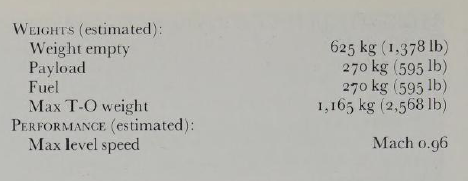

From JAWA 1988.

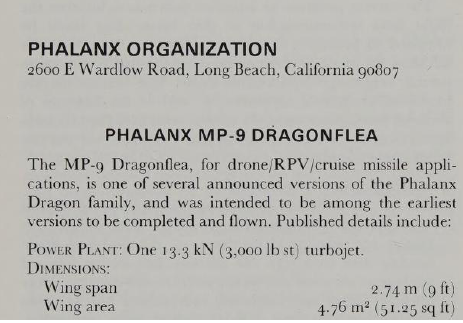

From World unmanned aircraft,
does anyone hear about Phalanx MP-9 mini RPV ?.

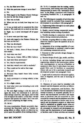

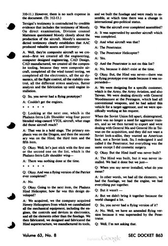

A few interesting notes from a rather mind-numbing volume of Securities and Exchange Commission cases dated
October 1996 to Jan 1997. Volume 63. Pg 894 of 1348. I have included just the page that relates to this forum topic, believe me the rest of it isn't worth the download - unless you need something to get yourself to sleep..
It gives some limited details of the proposed Phalanx designs and some info about related propulsive/vertical lift systems.
I haven't found this info published anywhere else so I thought it would be of interest for fellow members and possibly "fill in some blanks".

Found some more information from the same CCH SEC Docket. Volume 63 Issue 8. December 19, 1996. Pages: 898-899/1348. According to the testimony of the CEO/President the Dragon was "apparently" almost complete, except for engines when the project was suspended. There is mention of the other Phalanx/AAC projects, how far they actually went and some of the reasons why they were put on ice or canned. When this report was written the insolvent AAC company had already filed for bankruptcy.
In other words, while this may be cruel, the cynical individual would consider that they had a shiny exterior frame which was probably fibreglass, and the part that would have required something beyond even 2020 SOTA--and something that just about anyone would have realized was essentially impossible, especially when you bring up "Mach 2.5" was conveniently missing and unable to obtain.
I absolutely agree, although reported claims by the company of investigating supersonic versions of the Dragon family does not imply that the MP-18 was supersonic. The "apparent" difficulty in getting TFE731 biz-jet engines for the definitely subsonic prototype Dragon MP-18 would indicate a lack of money. However I "THINK" the over-enthusiastic press was thrown a "supersonic" bone by the company, and they ran for it. In the end (and either way) it was publicity exposure for the company that was hard pressed selling anything.

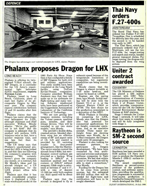

Here is an article from Flight International, 19 June 1986, a much better scan than the ones provided on their site.
It was NOT a swindler.
