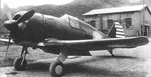

I found in this two experimental fighters produced in China during 2 WW at these links:
http://cwlam2000hk.sinaman.com/cafx15.htm
http://cwlam2000hk.sinaman.com/cafx16.htm
Anyone can give me more information?

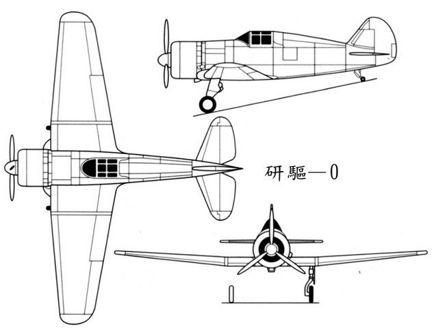

has anyone a drawings to those airplanes ?.

It is the 1943 Chu X-P0 prototype (produced at AFAMF No1, Kunming), designed by Maj-Gen Chu Chia-Jen.

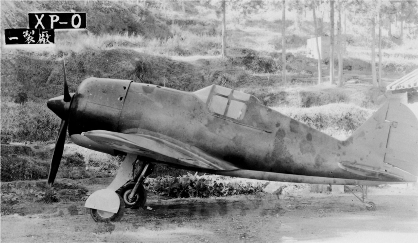

... the correct designation for the fighter plane called "X-PO" in this thread is actually XP-0.
In this thread? The aircraft's designation is only mentioned in two posts. In the first it is given correctly as XP-0. In the second, blackkite is quoting airwar.ru - the source of the 'X-PO' (originally given as a Cyrillic Kh-RO).
Both of those prototypes are illustrated (1/72 scale 3 views) in Justo Miranda's book "Enemy at the Gates."
I know that, but airwar.ru has the aircraft's designation wrong (the title of the page should have been updated to read XP-0 rather than XP-0).

XP-0 at least 5 built and have different appearance. First Prototype look like P-36A, but you can see the photo in sinorecords, it have a different appearance in wheel and cockpit.
