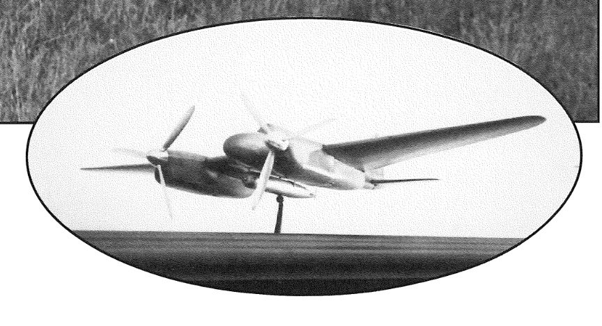

"Stelio Frati and his first aircraft design, a torpedo bomber done for his master's thesis in 1942."
source: http://www.seqair.com/Frati/VisitwFrati/VisitWith.html

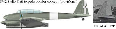

Does anyone knows if this design was pursued further during Frati's time at Aeronautica Lombarda? It was the AL 12P assault glider that got me wondering (the shape of the vertical tail/rudder is very similar - see provisonal sideview).
http://www.mugellogliding.aero/silenter%20deleo/silenter%20deleo3.htm (dead link)
https://web.archive.org/web/20060508032210/http://www.mugellogliding.aero/silenter%20deleo/silenter%20deleo3.htm
I know that Frati worked on the AL 12P (as well as the Assalto Radioguidato along with Ermenegildo Preti) while at Aeronautica Lombarda under Sergio Stefanutti. Frati left Lombarda in 1944 but relations must have been good since, along with Ambrosini*, the firm produced Frati's F.4 Rondone after the war.
Again, it seems reasonable that Lombarda (or Ambrosini) might have taken Frati's torpedo bomber concept seriously. Any further info on this?
Cheers
[* Relations between SAI Ambrosini and Aeronautica Lombarda were obviously pretty incestuous. Ing. Angelo Ambrosini was director of SAI, his brother Romolo Ambrosini started Aeronautica Lombarda. Stefanutti designed for both companies.]

It seems to have some Japenese influence in the design.
It is interesting to observe the use of two Isotta-Fraschini, liquid cooled engines as the SIAI's fighters S-207 and S-407.
But is unlikely that this thing could go further in the caotic climax of 1942.
At that time there were too much projects coming togheter in Italy and few resources to produce them, not speaking about the fact that a lot of projects (espcially fighters) were concurrents and duplicated (or triplicated).
Taking, for example, the history of "5 series" fighters (MC 205V, G55 and RE2005).

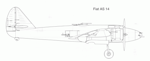

Agreed archipeppe. From a Regia Aeronautica point of view, there'd be a host of reasons not to accept the Frati design. The SM.84 already existed and fighter-based torpedo carriers were in the works.
If a smaller torpedo bomber was desired, the CMASA AS.14 or CANSA FC.20 could have been adapted without impinging upon supplies of RC.21 engines.
Aeronautica Lombarda may also have been too small a firm to launch such a project. Mostly I was just curious to know if Lombarda might have tried it on anyway.

Three observations: the S-207 and 407 fighter were from SAI, not SIAI. SIAI was charged to produce some 600 SAI-403 (never started).
The problem with Frati design wasn't that the situation was chaotic, it was that the Regia had already a lot of torpedo bombers projects up in the air, and no one produced to substitute the SM-79... (BZ-303, a Caproni, a SIAI, etc etc).
Frati and Aeronautica Lombarda hadn't a chance. Besides, by that time all aeronautical production was organized in "rings", linking a lot of companies on a little numer of projects (e.g. Centauro Rings, "anelli Centauro" to mass produce the G-55). The "5" series story is different from that, there was no intention to produce all 3. The 205V was mass produced only because the winner, G-55, was so late in series production. Besides this, the C-205V and G-55 would have been a fine couple: first excellent at low and medium height, G-55 at high height (above 8000 mts). Despite all was said, the Re-2005 was doomed. BTW, the real Macchi contender to the competition was the C-205N, but still the G-55 was better at altitude.
And the SAI fighters engine were Deltas III, air cooled. ;D

So, as for "trying it on", you're saying that Aeronautica Lombarda was outside of those "rings"? If so (and all that pre-existing competition aside), it wouldn't have mattered if the firm had wanted to pursue the Frati design anyway.
Just from cowling appearance, I'm assuming that the Frati design would use the same Isotta-Fraschini Delta RC.21/60s as the SAI.207.

I have noticed that Frati Torpedo Bomber concept seems built around Isotta Fraschini Delta
Yes. In reply #4, Skybolt identified the engines as Delta IIIs ... so, Delta R.C. 40-I (III Serie).

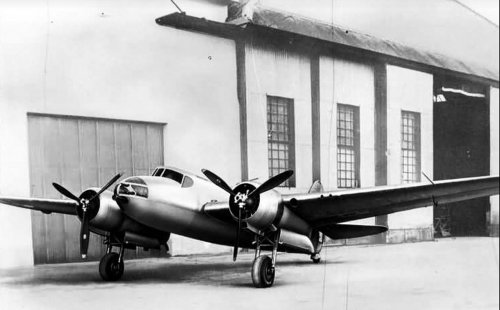

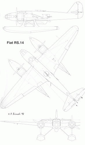

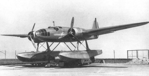

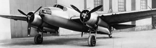

Hi FIAT CMASA AS.14 land base attack bomber.
AS.14 base was RS.14 seaplane.
Only one AS.14 was made in 1942 and tested.
Wing span, m 19.54, Length, m 14.10,
Wing area 40.00 m2
Mass, kg
empty aircraft 2650
normal takeoff 8150
Engine type 2 DD Fiat a. 74 RC 38
Power, HP 2 x 840
Maximum speed, km/h 420
Cruising speed, km/h 375
Range, km 2750
Service ceiling, m 5500
Crew, pers 3
Armament: one (45) 47 mm Breda cannon with ammunition in 36 rounds
five (two) 12.7-mm 0.303 machine guns and
one or two 7.62-mm machine gun Breda-SAFAT MACHINE GUNS
bomb load of up to 600 kg in bombootseke
http://www.airwar.ru/enc/bww2/as14.html
