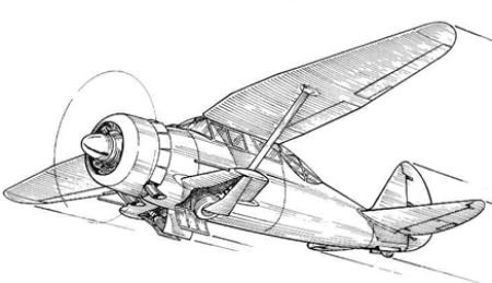

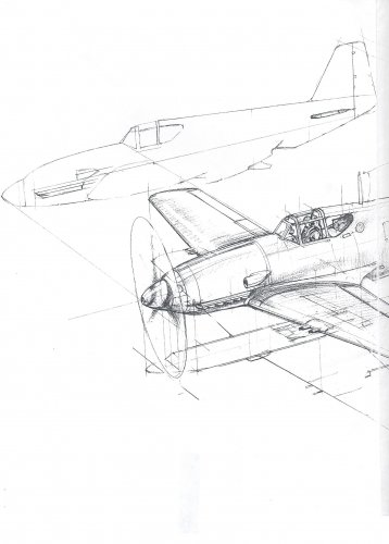

Looking for information about the Swedish SAAB L23 J23 "Swedish Mustang" I came upon this picture of a purported 1939 AFF P7 scout. Does anyone else have better information about this fascinating looking aircraft? Thanks

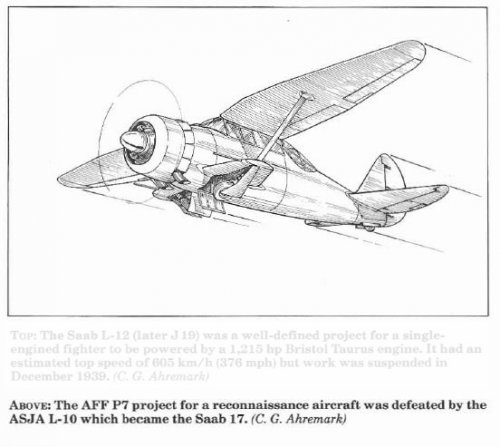

My two cents...

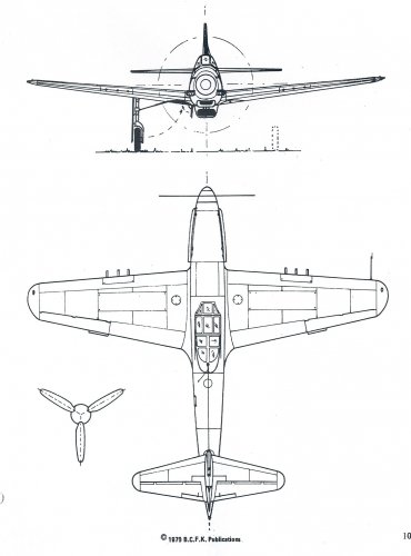

This pictures from "SAAB Aircraft since 1937" [Smithsonian Institution Press]
1)-page 22
2)-page 59

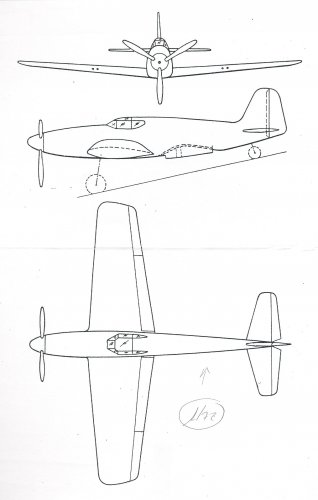

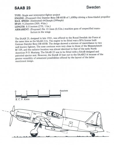

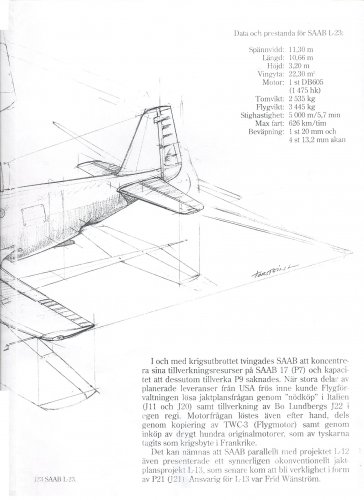

I have found some J-23 info
Post-1

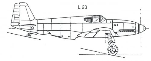

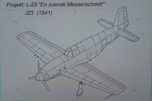

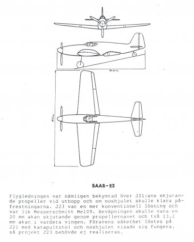

J23 Two very different looking fighters
Why are there two very different looking drawings for the J23? Is one an earlier version of the J23? If so, which one is which and what caused the changes? Additionally, does anyone have a drawing of the AFV (AB Flygplanverken) GP 9?

AFF P 7 'Scout': I have that as an army co-op aircraft. Although the P 7 designation suggests it was in the level bomber contest - P 7A was the ASJA L 10-2 (Saab B 17A prototype), P 7B was the ASJA L 10-1 (Saab B 17B prototype).
Very interesting! Thank you. What about the two versions of the L23? One with a bubble canopy and one with the streamlined "razor back" canopy.
