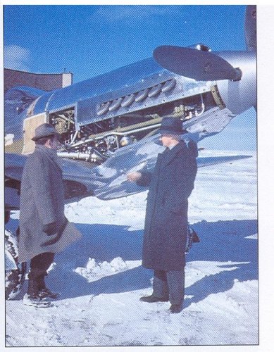

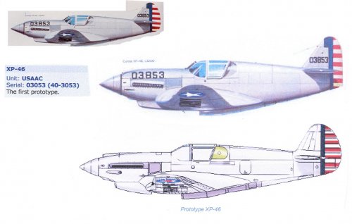

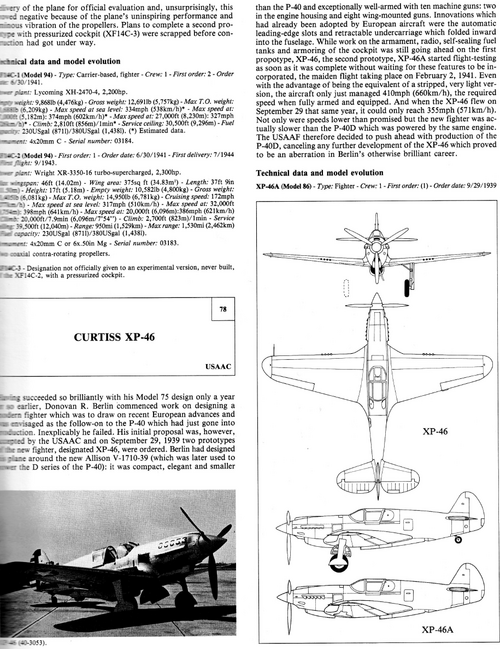

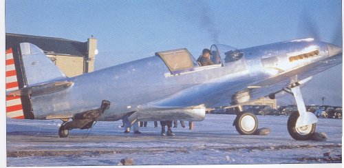

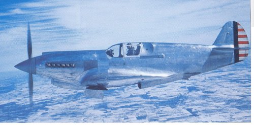

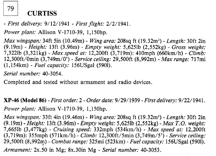

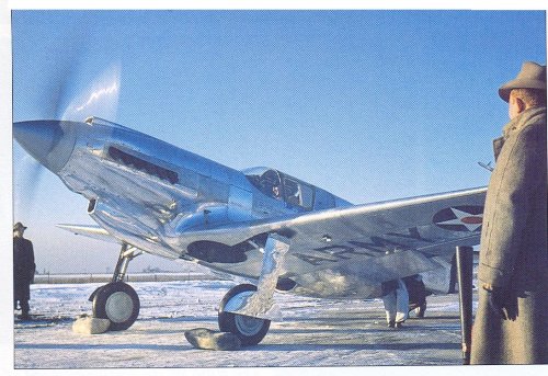

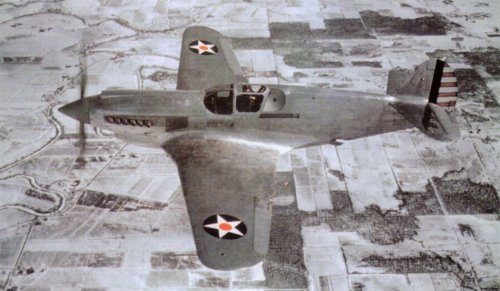

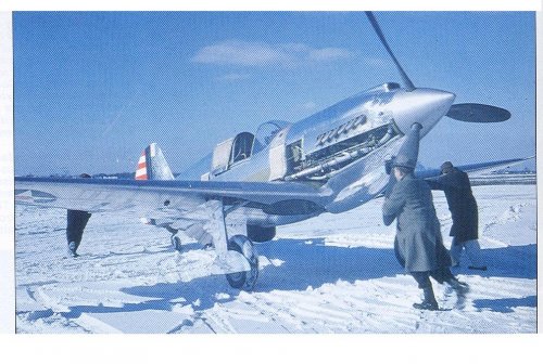

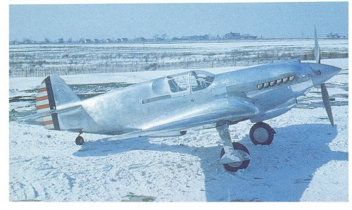

Some additional info -Post-1

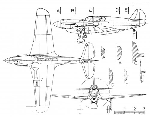

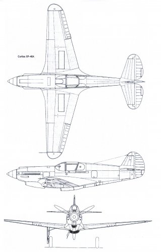

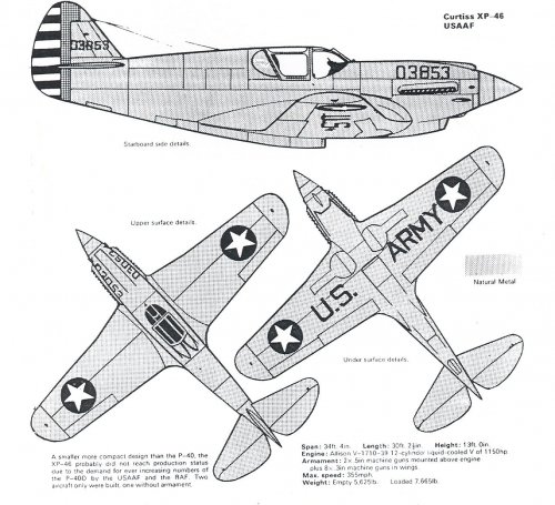

A drawing by Jan Kadlec from Czech L+K magazine, 9/1969:

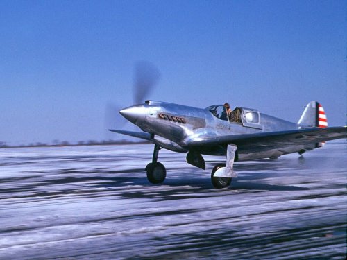

Here's a shot I haven't seen before of the unarmed XP-46A (40-3054) doing what looks like a high-speed taxi test. -SP

Has anyone read of an explanation for why some of the pictures show the inboard landing gear doors open when they should be closed?

I have never seen the Profile General Arrangement drawing showing location of radiators for glycol cooling as well as the oil cooler.
Does anyone know where I can look?
