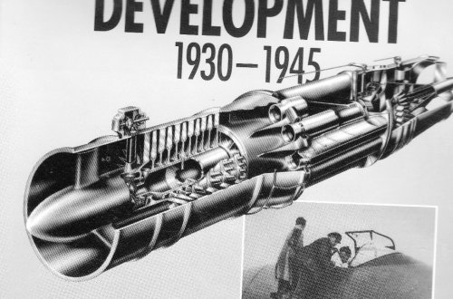

The designer of the 011 said the He 006 was the better engine If it was fully developed it was to put out 2650lb's. From the book German Jet Engine By Antony Kay my cutaway is not good enough.
