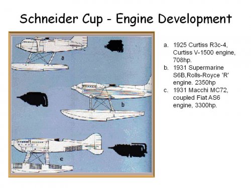

To me the "steady incremental improvements" were in existence back 1931 Scheider Cup Racers and that aircraft engine improvement was stifled when England retired the Schneider Cup Race.
