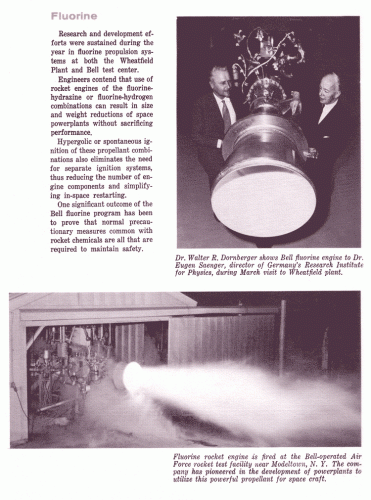

From an Bell Aerospace company publication of the early 1960s...
